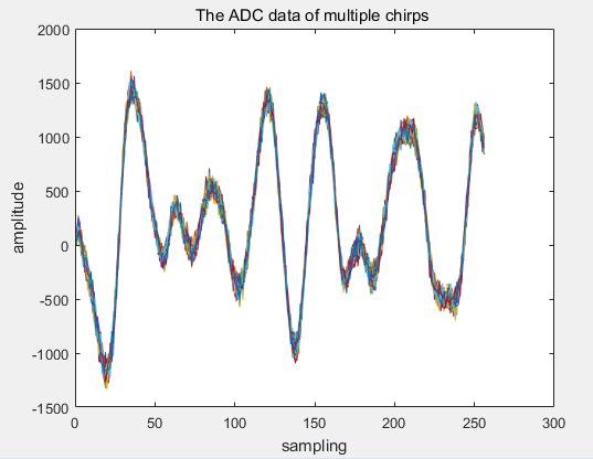

  • Hi ,
    1、The ADC data of multiple chirps can not see the jump, but the phase noise is not very ideal

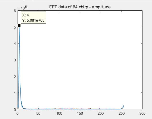

  • HI,
    Can you plot the real and imaginary ADC data separately to double check?
    Can you plot the range FFT output to see how big is the peak associate with the target?
    Can you plot the real and imaginary of the range FFT output separately to check?

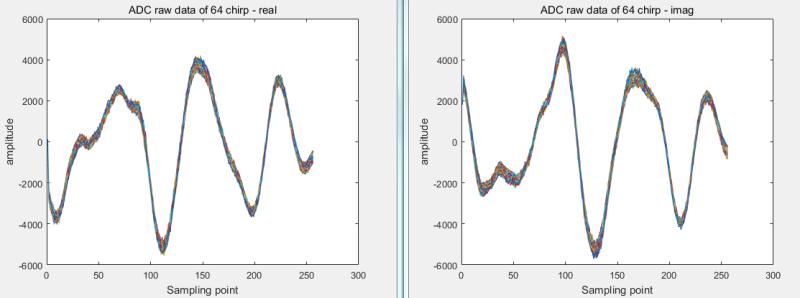

  • Hi ,
       ADC raw data  ,FFT data of 64 chirp -amplitude
      The fundamental reason lies in the poor phase determination of the radar received signal. But the ES1.0 didn't have that problem.

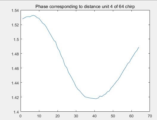

  • HI,
    Your recent phase figure shows the variation from 1.42 ~ 1.53 rad.  It is not the same as the original one that have a big jump from 1.369 to 2.627 rad.
    Are we talking about the same setup and same target?
    Zigang
    It's not the same target, but it's all static. It means a stationary target, which may have a jump or other unstable phase change

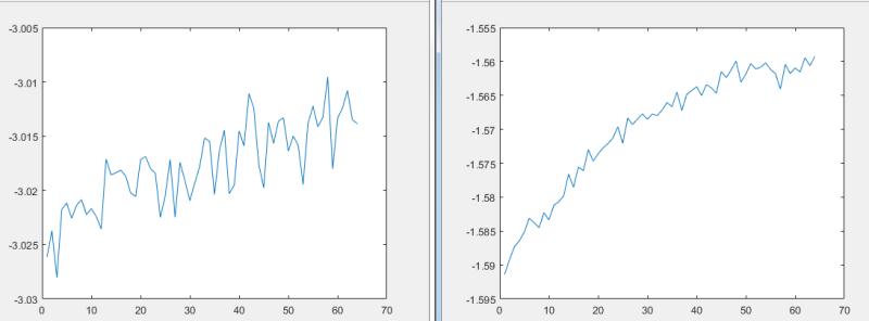

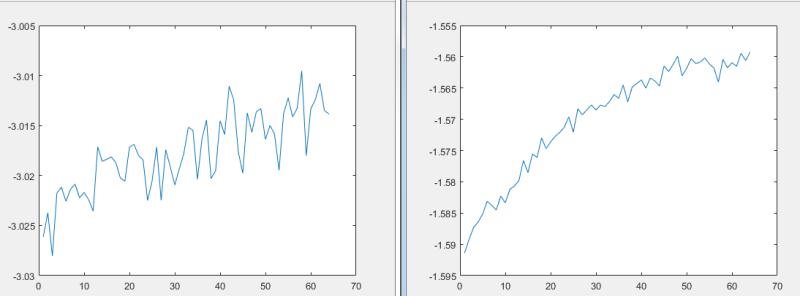

    Es1.0 on the left and es2.0 on the right. Phase of the same target
    ES1.0 and ES2.0 waveform configurations are the same
    sampling rate:12MHz
    chirp rate   :9MHz/us
    Single chirp sampling points :256
    Chirp number :64
    f0=61GHz
    idle time=9,adcstarttime=30,endtime=60,txstarttime=1,FRAME_PERIODICITY_VAL=100
    2T4R
  • HI,
    Thank you for your confirmation.   We do found that at 61.2G, ES2 board has a small clock spur.   ES1 board has a bigger clock spur at 62.1G.   So ES1 and ES2 are different.  Is it possbile to move away from the 61.2G, say move start frequency to 61.21G?  This problem will also goes away if you have a wider RF bandwidth, say 1GHz bandwidth.
