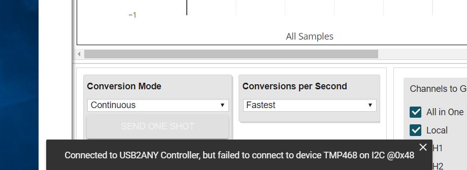

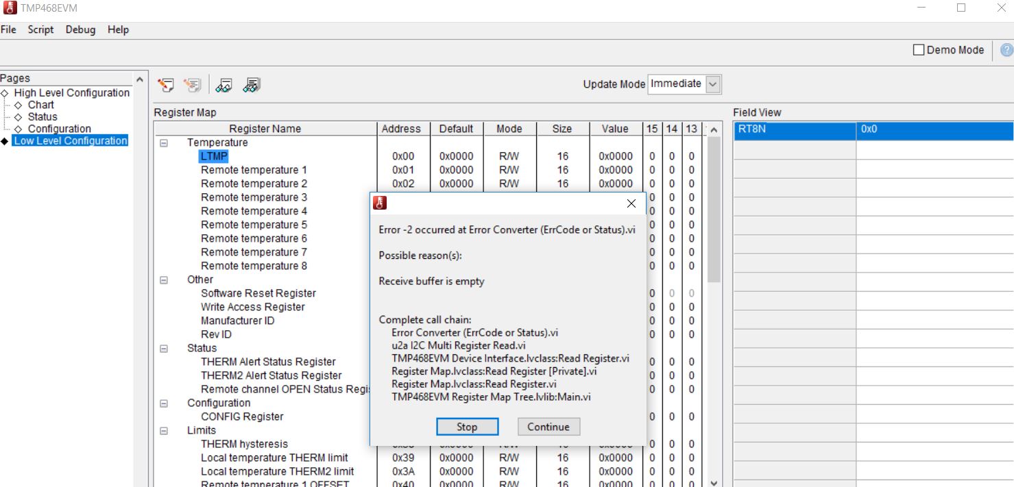

Hi
when i open tmp468evm, i got this error.
what can i do to solve this problem?
thanks.

Netanel,
Can you please try the latest GUI at https://dev.ti.com/gallery/info/THSApps/TMP468EVM_GUI
Hi Netanel,
Please check that the ADD pin is still set up GND. This error message usually occurs when the device is on the wrong I2C address.
Hi Netanel,
Can you also send me a oscilloscope waveform of the the I2C transaction when you try to connect to the EVM to the GUI?
