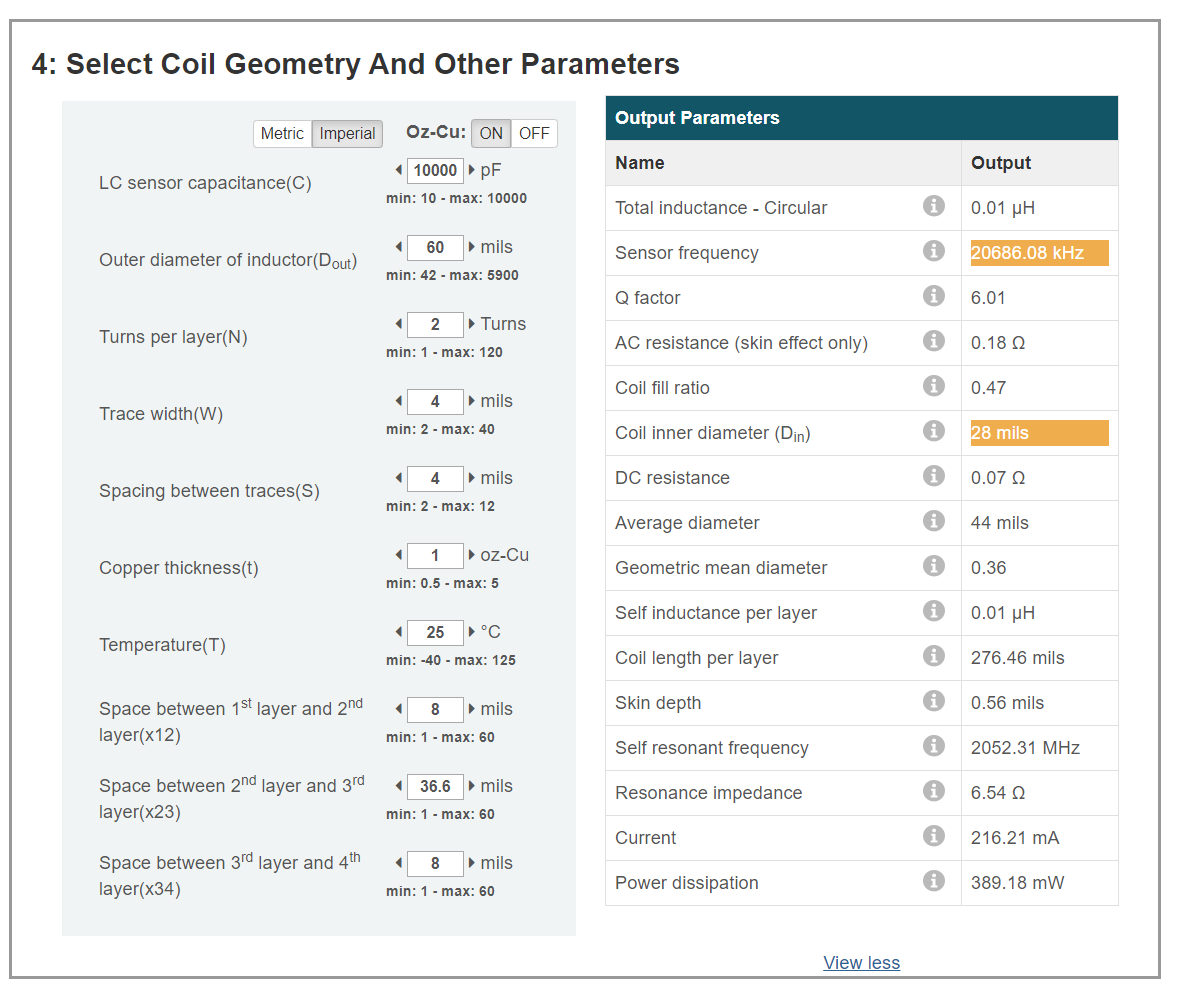

Dear Team,
For measuring a 2-mm target with LDC0851, I use webench to get below coil specs.
May I confirm with you if below coil and compatible 10nF is optimized for the application?
The outer diameter is set by 2mm x 0.8 = 1.6mm = 62.999mil.
https://webench.ti.com/wb5/LDC/#/spirals?shape=Circular&lcTanKCapacitance=10000&turns=3&layers=4&spaceBetweenTrace=4&traceWidth=4&copperThickness=1.000&dout=62&temperature=25&partno=LDC0851&voltage=1.8&x12=8&x23=36.6&x34=8
Thank you.

  • Hello Ting,
    Unfortunately the Webench tool does not save your input when you link it. Could you take a screenshot of your inputs and share them?
  • Hello Kristin,
    It seems below design for the coil is at margin spec.
    May I know if you could suggest a coil and It seems below design for the coil is at margin spec.
    May I know if you could suggest a sensor design to meet measuring 2-mm target? Thank you.
  • Hello Ting,
    This coil is not feasible for any of our inductive sensing devices. The LDC0851 requires a minimum sensor inductance of 1.8uH in order to drive the sensor, and our other LDC devices have minimum resonant impedance requirements (the very lowest is 350 ohms).
