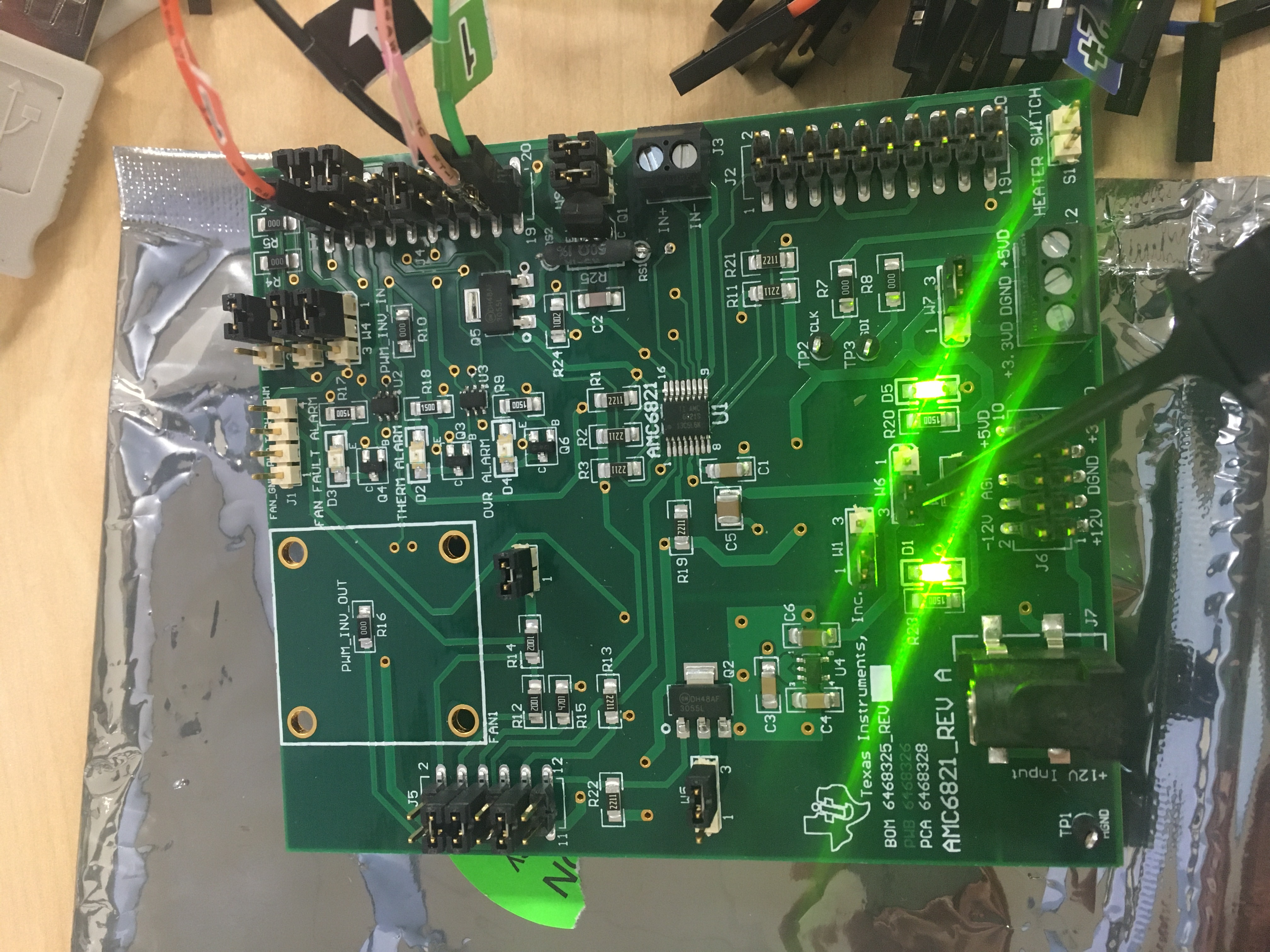

  • Hi Shubhakara,
    I am able to see the PWM signal with those settings on my set up.  Can you please send me your schematic.  Also, to what value is register 0x22 set?
  • Shubhakara,
    Thanks for the information from these threads e2e.ti.com/.../871574 and https://e2e.ti.com/support/sensors/f/1023/t/871579 .
    Please check jumpers W7 and J5 pin 9-10 connection for PWMOUT Pull-up.
    Do you see the PWMOUT waveform without the fan connected to the EVM?

    We are testing this TI's AMC6821 EVM with Xilinx ZCU102 board (having zynq ultrascale+ on it) which works at 3.3v. Therefore AMC6821 EVM is jumpered to work at 3.3v
    We are able to see 3.3v VDD on Pin-6. But on PWM-OUT Pin-1 we always observe fixed 1v all the time on the CRO. Never seen any waveform, irespective of what values we try writing to DCY register and other configuration registers.
  • Hi Shubhakara,
    For clarification, when you say "observe fixed 1v" do you mean fixed high (3.3V) or is it the pin pulling the pull-up voltage down to 1V?
    Can you check the status registers 0x02 and 0x03 to make sure there are no faults that might cause PWMOUT to stay high?

  • Hi David,
    When i say "observe fixed 1v", i am talking about reading voltage value of 1 volt on oscilloscope (not the logic level of 1). So yes, it will be correct to say that the pin is puling the pull-up voltage down to 1V. On J5, 9 - 10 shorted (connected) and 11 - 12 are left open.
    When i measure the terminal of R13 that is connected to VDD, it measures 3.3V but on the terminal of R13 connected to pin 10 of J5 measures 1V.

  • Hi Shubahakara,
    Please check the pull-up voltage and the jumpers on your board.  This pin is open drain so I do not expect the voltage to be much less than the pull-up voltage. I am sending you a picture of my EVM configuration for reference.
  • Hi David,
    Thank you so much for your Valuable Support , The issue had been Solved, The chip had gone Bad, We replaced one more chip then it works fine.
