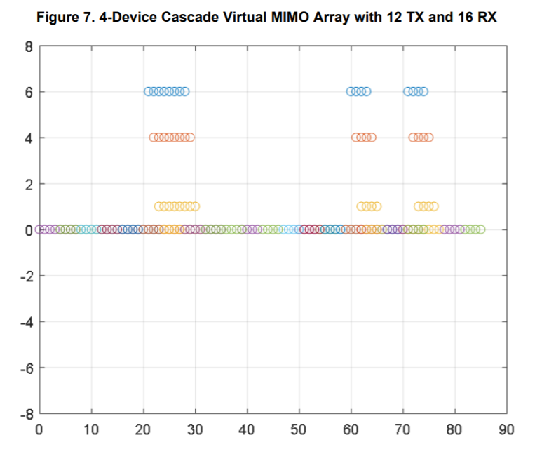

  • Can you send a link or website?
    I am working on Imaging Radar Using Cascaded mmWave Sensor Reference Design - --- awr1243。
    Has the board been released  ? When can I expect to buy?and What does the figure below mean specifically? I think that it don't match the Actual array antenna.
