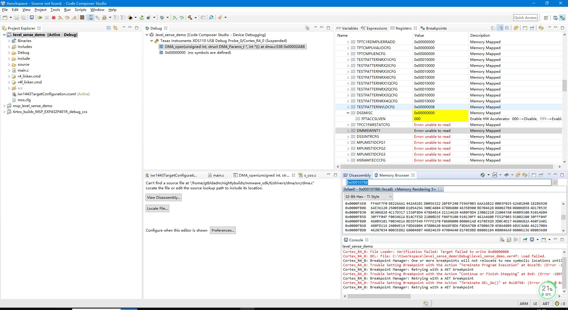

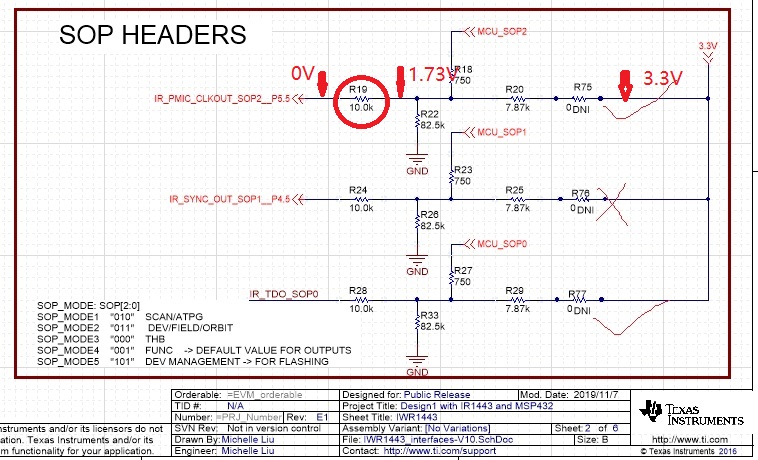

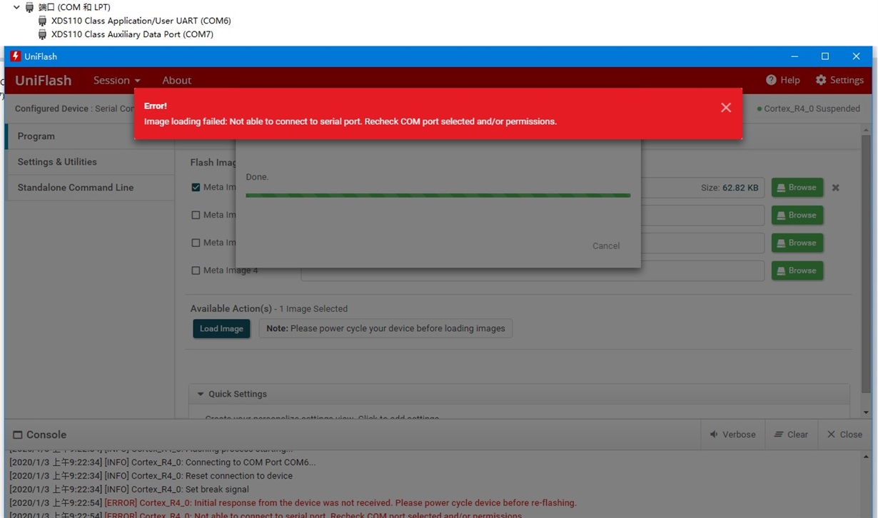

i have design my board as <design1 with ir1443 and msp432>,and now i can not get in the flash mode for Uniflash; i have connect  SOP2 to 3.3V,SOP1 to 0V,SOP0 to 3.3v,but i check the Vot in iwr1443 pin P13,it was still get 0v,is it correct?i can connect to Cortex_R4_0 in CCS. any thing i need to do?thanks.
