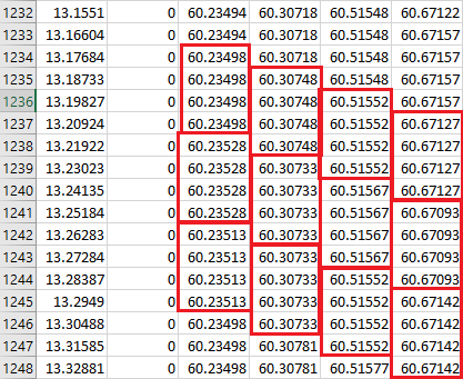

Generating Timestamps
The sampling time for four channels is known (42.498ms), and I have verified that the capacitance readings change approximately every 42.498ms (every 4 rows in my log.csv -- see below).
However, the timestamps I am creating (using time.time(), in python) are not increasing exactly by 42.498/4=10.6245ms increments. This is easily apparent when viewing the graph (see below).
This means that my timestamps are inaccurate.

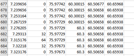

3. When/if my python script falls behind the input buffer (more than 32 bytes accumulate in the buffer), the timestamps will become even less accurate. Do you have any advice for dealing with this scenario?

4. Log data in csv, including: [timestamp, bytesInWaiting on serial port, c0, c1, c2, c3]

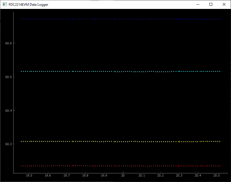

The output looks like this:
The plot looks something like this:

    Unfortunately, it's impossible for me to look through the code to see how the GUI is doing this. Additionally, our expertise is on the FDC2214 itself, not embedded programming, so my help might be limited.
    The GUI is probably doing something similar to what you're doing. The sample times reported are not exactly even. You can see this if you open up the logged data.
    Another option is to not use the streaming mode and manually poll the EVM for data with read/writes. This option might be better if you are unable to keep up with the buffer.
