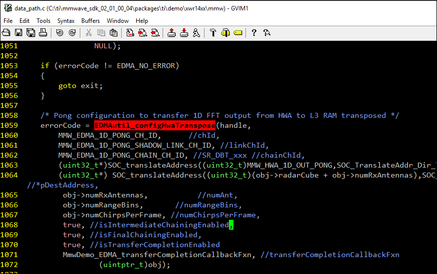

I am working with the high_accuracy_14xx_mss lab.

  • Hi Nitin,
    I was out the last several days.  I tried your suggestion today, and you were spot on.  When I looked at the MmwDemo_EDMA_transferCompletionCallbackFxn() function, I found that the function uses the 'arg' argument as the pointer to the data path object in the firmware:
    MmwDemo_DataPathObj *obj = MmwDemo_DataPathObj *)arg;
    This is the way it is done in several labs in the toolbox.  Using a breakpoint in the function, I found that 'arg' was not set to the address of the datapath object.
    The 14xx_high_accuracy lab sets a callback function and argument in the EDMAutil_configHwaTranspose() function, which I used as a model:
        config.transferCompletionCallbackFxn = transferCompletionCallbackFxn;
        if (transferCompletionCallbackFxn != NULL) {
            config.transferCompletionCallbackFxnArg = (uintptr_t) transferCompletionCallbackFxnArg;
        if ((errorCode = EDMA_configChannel(handle, &config, true)) != EDMA_NO_ERROR)
            System_printf("Error: EDMA_configChannel() failed with error code = %d\n", errorCode);
            goto exit;
    So the callback function is registered through the EDMA_configChannel() function.  Note that the arguments for that function contain the EDMA handle and the config structure, but no apparent reference to the datapath object required by the callback function.
    I then changed the MmwDemo_EDMA_transferCompletionCallbackFxn() function to explicitly point to the datapath object in the firmware
    MmwDemo_DataPathObj *obj = &gMmwMCB.dataPathObj;
    The function completes without error, and the pending on the semaphore works as well.
    So it appears that somehow, the EDMA setup is missing the code that correctly sets the 'arg' in the callback function.  How does that happen so that I know what went wrong and can avoid that in the future?
    Alan
  • Hi Alan,
    Sorry for the late response. Good debugging. I'll need to check the 14xx_high_accuracy lab but the mmw demo in SDK 2.1.0.4 does pass both the transfer completion callback function as well as the obj argument, for transfers wherethe transfer completion callback is registered. Please look at the code below.
    -Nitin
  • Alan, I have updated my response above. The Transfer Completion function does take the DataPathObj as you noted and the same is passed in the code snapshot I shared above.
    -Nitin
