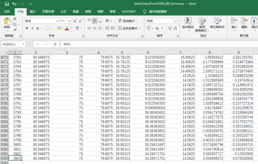

When I run the lab of vital sign, I extract the data using matlab and I found that rangeProfle_cplx matrix has many columns.
I use the default parameters and the frame rate is 20Fps.
and if I save data for 70 seconds, I think the rangeProfile_cplx matrix should be 70*20 columns.
But in fact it has 50040 columns. I don't know why.
I'm confused, I want to figure out the columns of the rangeProfle_cplx matrix.

  • Hi Nitin:
    Thank you for your reply.
    Yes, I use the parsing script you told me. There is the same problem.
    I think the total Frames not equal to the record time* frame rate.
    The example TI provided in vital signs parse the data and the total frame is 3803, does that means the record time is be 3803/20=190seconds?
    I'm confused about the total frames not equals to record time*frame rate.
    Can you explain this?
    Qi
  • Hi Qi,
    Thanks for your patience. I was able to reproduce the behavior you mentioned above and found the reason for it looking at the GUI source. The reason for these extra frames in dataOutputFromEVM.bin is that the GUI opens this file in append mode which causes the new data to be added to any existing data in the file from a previous run.
    To avoid this, please delete the data file from the gui_exe directory before running a new capture:
    labs\vital_signs\68xx_vital_signs\gui\gui_exe\dataOutputFromEVM.bin
    You should also delete the following .xlsx files generated in the same directory by the parser utility, before running the data capture.
    dataOutputFromEVM_RP.xlsx, dataOutputFromEVM_Summary.xlsx, dataOutputFromEVM_vitalstats.xlsx
    I tried a new data capture after deleting the above files and was able to get the correct number of frames after parsing it.
