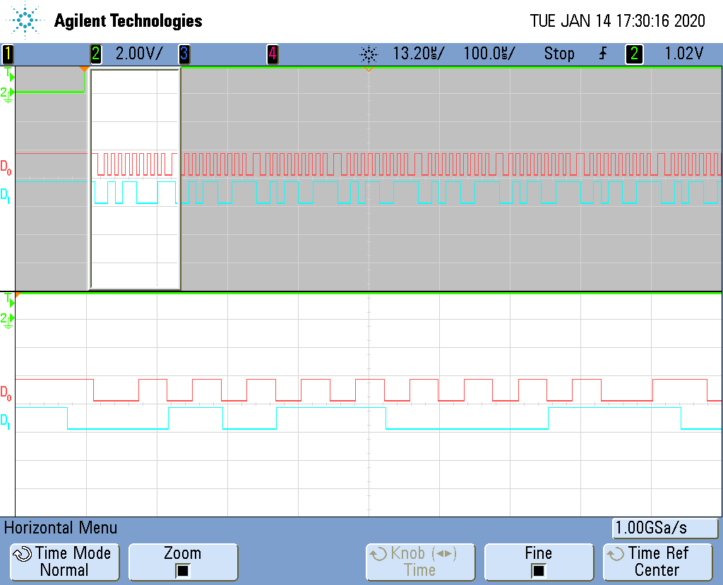

I am using tmp175 for a project, however when I send the address 0x2C of TMP175 (A0: Floating, A1: GND, A2: GND) I receive a NACK in the ACK bit,
You will find attached the scoop screenshots.

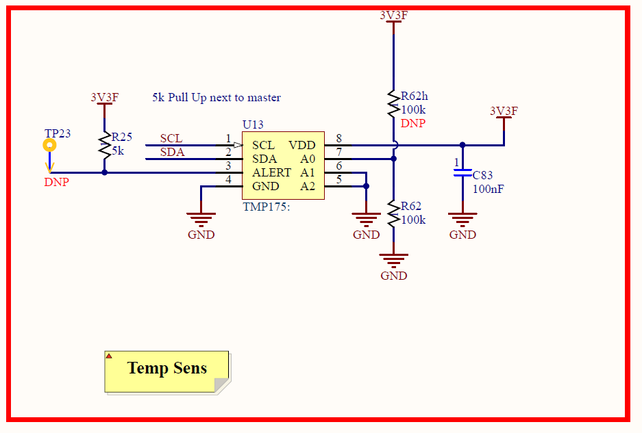

    I see the NACK you are receiving, it looks to me that your addressing is correct based on your description. To start troubleshooting, can you verify the TMP175 is receiving power, and share the relevant part of your schematic?

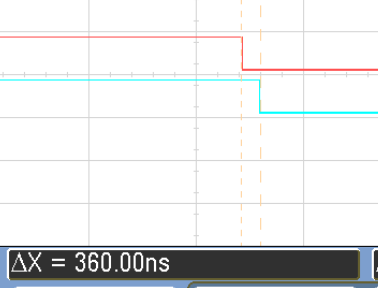

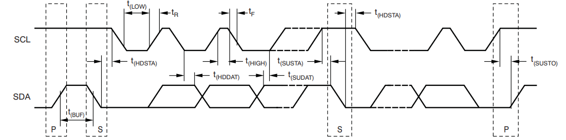

    Also, i see several instances where the SCL goes low and SDA changes at what appears to be the same time, this is shown as t(HDDAT) on the TMP175 timing diagram.
    Can you zoom into one of these edges? The TMP175 has a minimum t(HDDAT) of 4ns, the device can have communication issues if that timing is violated.

    - THDDAT: 360 ns Falling edge

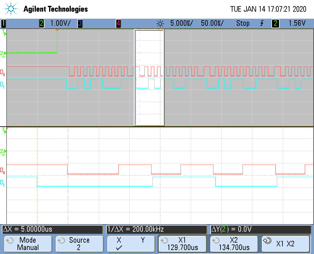

    - TSUDAT: 5us
    - Different timing requirements

    - I2C speed is at 100kHz (in Fast Mode)
    THDDAT :                                                                                   TSUDAT :
    Schematic : ( 5k pullup SCL & SDA  next to master ) :

  • Hi Othmane,
    Your timing looks good to me. It does look like you are tying the address pin to ground via a 100kOhm resistor. I know this method works on some of our other temp sensors to register a float, but it may not be reliable since this isn't the intended setup of that pin. I also haven't done it myself with the TMP175 before.
    I see that you tried different addresses, does that include the 0x48 (A0-A2 -> GND) address? If possible, I would also suggest either removing or shorting R62 to see if the address detection on that pin is the cause.

    Indeed I have already tried to put A0 to gnd directly, to Vcc and floating. I removed the R62 to get floating.
