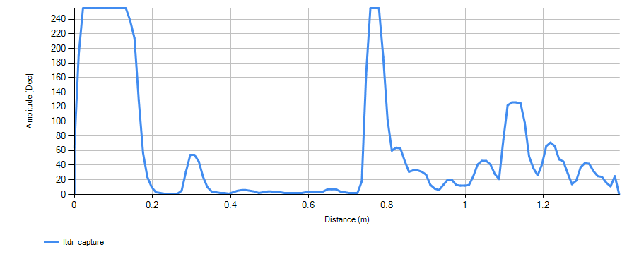

  • Hi Akeem,
    We have performed some tests and found some interesting. We thought that our MCU were causing the issue so we removed it from the equation and prepared the next setup:
    MSP --- XBee <---> XBee --- PGA460
    With this, we get the same result. We can configure the PGA460 profile but we cannot get a good curve in the GUI. It is cut. Please, check the image:
    Right after the bottom, it is set to 0 in the datapath even when the MSP is receiving all the curve (Checked with an FTDI):

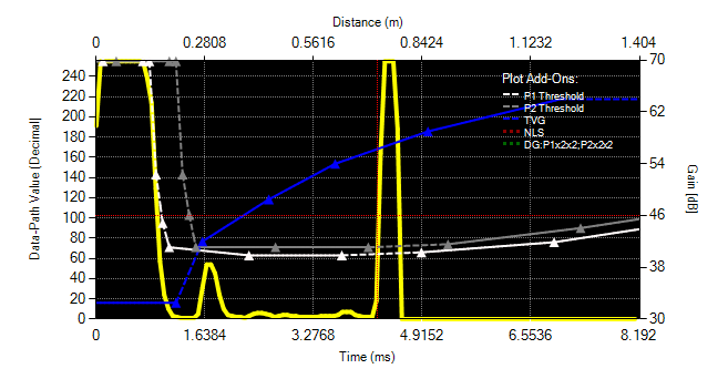

    40 80 3f 40 00 bf 40 06 b9
    Represented:
    I believe that GUI's timeout when receiving message is to tight for this setup. Would it be possible to have a version with a more soft timeouts?

  • Pablo,
    It appears that the echo data dump (EDD) is being disrupted a little more than half way through the record cycle. This is usually due to UART read of the EDD being disrupted by a subsequent command to the PGA460. The delay built into the GUI is based on the given record length and UART baud rate plus margin, so in your case of 8.192ms, the GUI should always allow for enough delay time between the EDD read command and filling of the UART buffer with the 128 bytes of data. Are you sending any auxiliary commands from the master controller during the EDD capture? Also, what UART baud rate are you using? If not the maximum, are you able to increase the baud rate to 115.2kBaud? I have confirmed the EDD is still fully captured when I set the record length to the 8.192ms and the lowest GUI supported baud of 9.6kBaud.
    The best way to determine this is by using a logic analyzer to see if the UART bus is reading all 128 bytes of EDD data. If so, then there could be a queuing issue in the GUI due to the overhead from the Xbee.
    One thing you can try as a workaround is increasing the record length cycle to check if the disruption occurs at ~50% of the given record length, or if it is always halted just before ~4.9ms. If it is always after 50%, and you only need up to 8.192ms, double your record length to 16.384. Yes, the resolution will decrease, but you will be able to continue with the evaluation.
