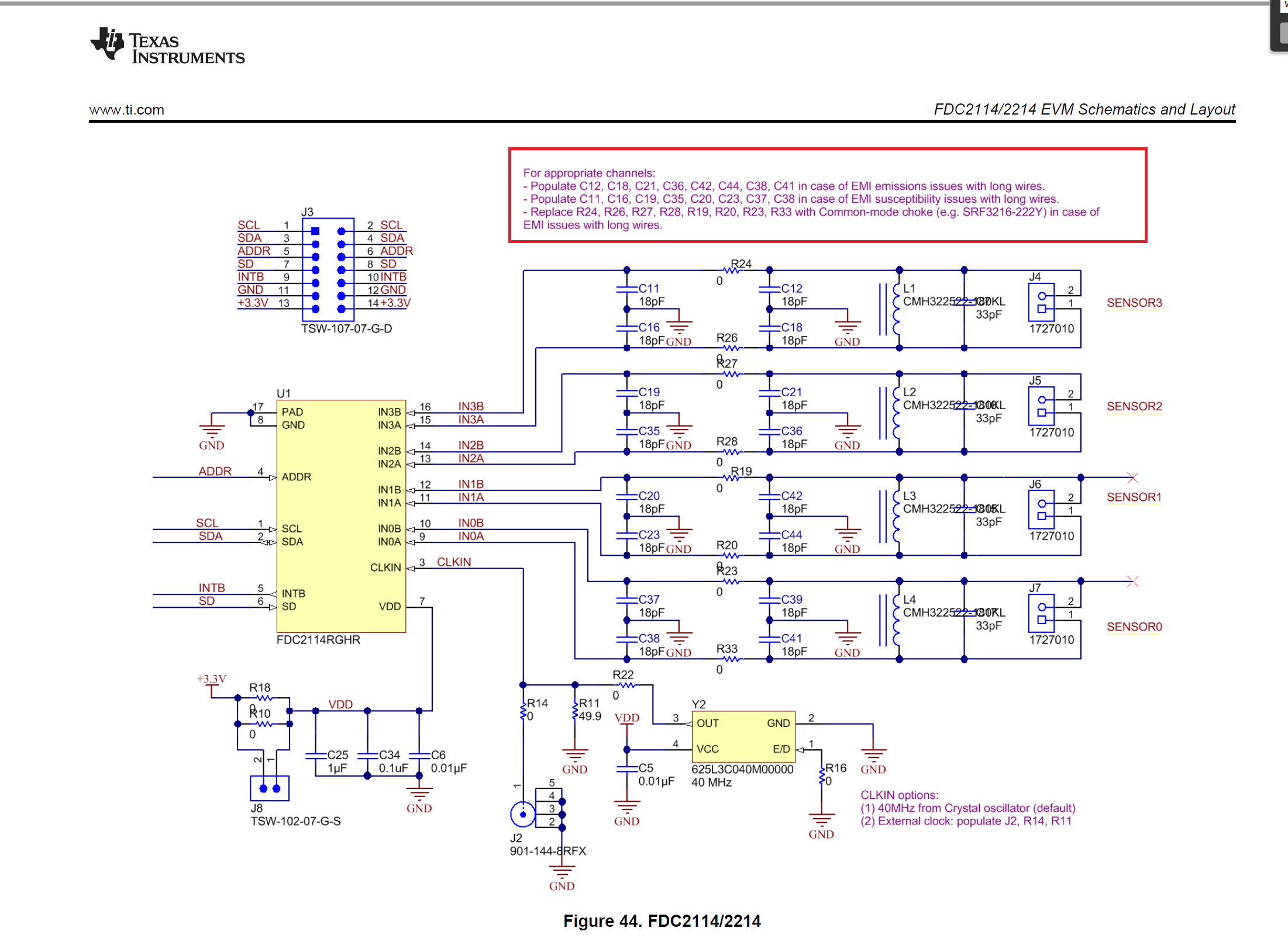

I use FDC2214 EVM for development.
When I was checking the schematic in the data sheet, I noticed the red frame shown in the figure.
How long does "Long Wire" mentioned here mean?
Since the length to the sensor is about 15㎝, if you are not worried about it, do you need to take special care?
I hope you can answer
Masato
  • Hello Masato,
    Yes, I would consider 15cm to be a long wire. I suggest adding footprints for these capacitors and common mode chokes to your design. You may not need to use them, but in case you do you can easily populate them. If you notice we have footprints for filter capacitors included on the bottom of the EVM.
