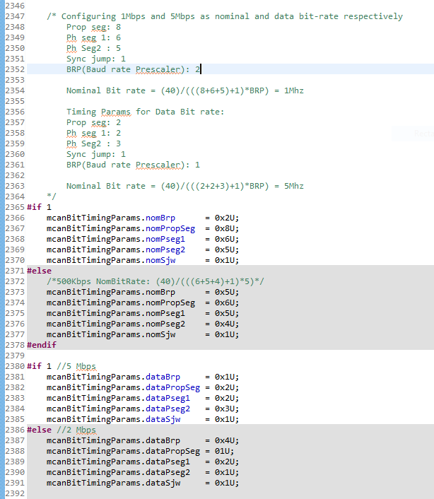

  • Hi Raghu,
    attached is the default values I'm using in the ODOC lab with MCAN set to Classic mode. I'm using a Kvaser Leaf Light v2 CAN interface, it's limited to 1Mbit/s. I'm then configuring the CAN channel in MATLAB to 1Mbit/s.
    I'm also not using the visualiser executable provided with the ODOC lab. When I run the lab in CCS debug mode, the DS3 led doesn't come on, it sits in MmwDemo_sleep(). Is this becuase the program is waiting for CLI to start the sensor?

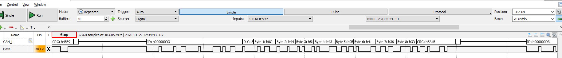

  • Hi Raghu,
    Using a Logic Analyser, I can see messages are being transmitted over the bus, as shown in the next image:

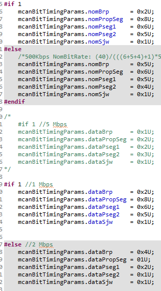

    I'm using the default ODOC lab, set to classic CAN mode with the following data bit rate settings to account for using a Kvaser leaf Light v2 (not PCAN-USBFD):
    Can you please confirm that the these 'classic' message frames can be read on a CAN 2.0 bus (not a CAN FD device)? In mss_main, I see that using the Classic setting limits the number of data bytes to 8. But does it send the 3 extra bits that differentiate CAN FD from Classic CAN, as shown below? If so, these frames won't be capable of being read on classic CAN bus.
    Brant

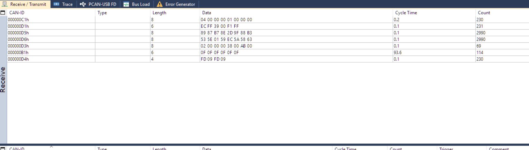

  • Brant,
    Have you ever been able to get the CLASSIC CAN working on this setup? Have you tried the sample test code in the "drivers\canfd\test" of the MMWAVE-SDK to check CANFD functionality . You could check this sample application by just changing the MCAN frame type to CLASSIC_CAN messages.
    For ODOC:
    Below are the only changes required in the ODOC (mss_main.c) for supporting the CLASSIC_CAN messages
    1. Change the MCAN Frame type in your initialization.
    CANFD_MCANFrameType frameType = CANFD_MCANFrameType_CLASSIC
    Below is the snapshot I captured just changing the above line in the PCAN-USB tool. I do not have the "Kvaser Leaf Light v2 CAN interface" to check it working using that tool.
    Can you check by modifying the transceiver compensation offset delay value?
    Change the "mcanCfgParams->tdcConfig.tdco " to lower value than 8U and see if the issue gets resolved?
    -Raghu
