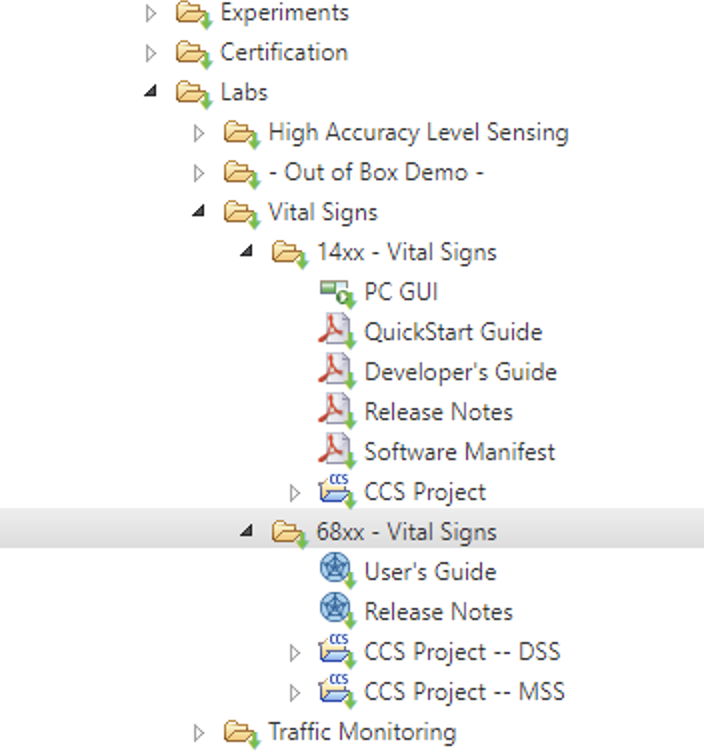

My end goal here is to get the Vital Signs Lab designed for the IWR1443 working on the AWR1843BOOST EVM that I currently have. I have gone through the code and made many changes, but haven't been able to successfully compile the project. Would someone be so kind as to list out everything that needs to be changed to get this lab to run on the AWR1843?

  • Hi Cesar,
    I looked in the industrial toolbox and couldn't find the project built for the AWR1642, are you possibly referring to the Automotive Toolbox Occupancy and Vital Signs Detection Lab? I haven't looked into detail about this lab but I don't think it fits our use case quite as well. Here is what I can see in the industrial toolbox:
    EDIT: I believe you are talking about the Driver Vital Signs Lab? Please let me know if this is the case, I will look into it further. But again, I would like to know what I need to change to get it to run on the 1843.

  • "a short explanation as to why a binary built for the 1642 runs on the 1843."
    The reason is that the AWR1843 device is a superset of AWR1642. The main difference between the devices is that the AWR1843 has 3Tx, more memory and higher IF bandwidth. None of these features affect the vital signs since this application uses only 1Tx
    "in the 2.9 automotive toolbox for the "Driver Vital Signs" lab does not seem to be building"
    Please make sure that the mmwave SDK mentioned in the release notes is installed"
