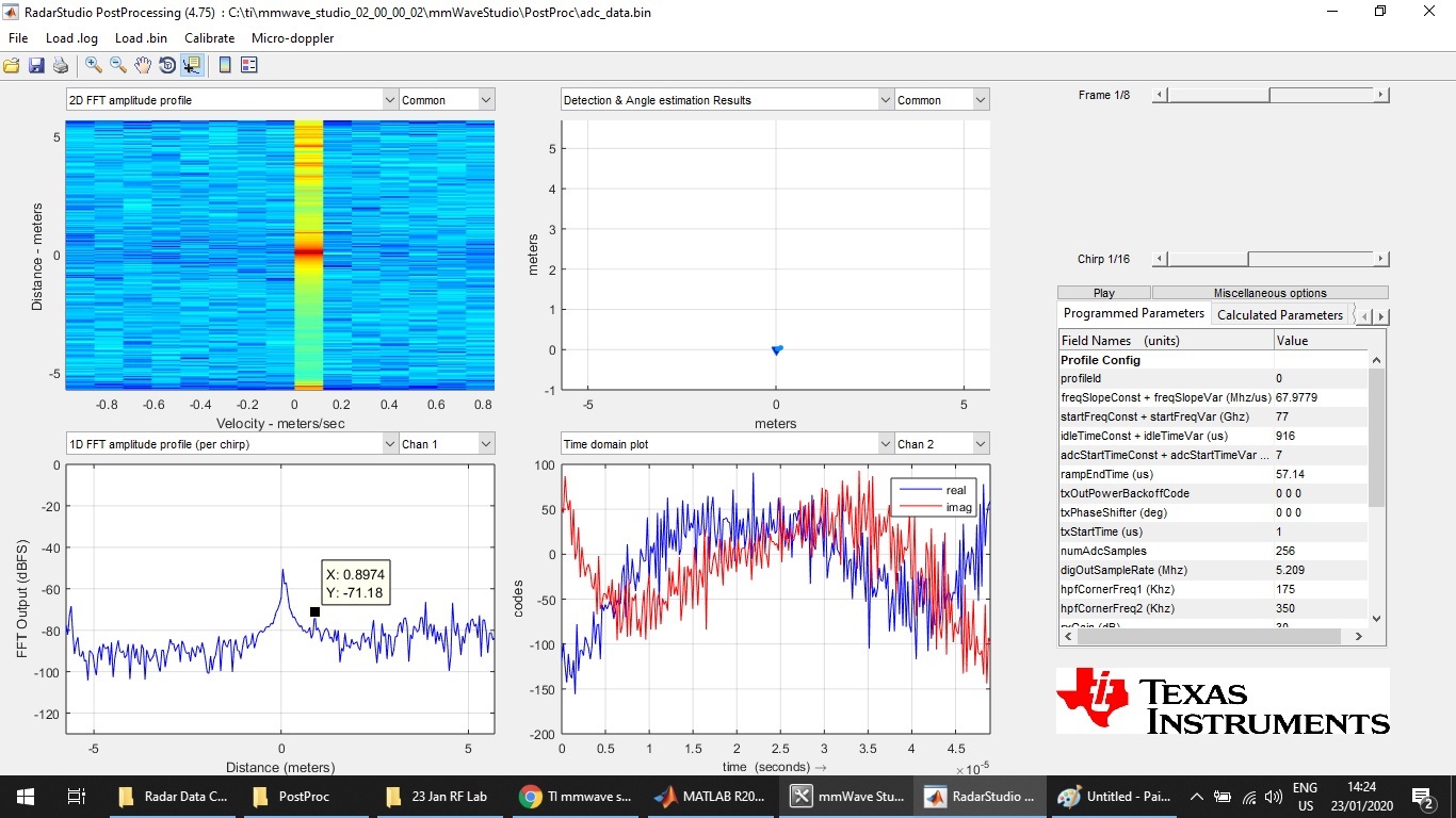

I am learning TI mmwave sensors using AWR1642 (ES2.0) + DCA1000 EVM with a Windows 10 laptop and mmwave Studio 02.00.00.02. I am collecting 2x complex data from the ADC.
Almost virtually always, when I study Range FFT in post processing by mmwave Studio, I find a peak that starts from Range 0 and decays gradually. The Range profile (inclduing noise floor and and target peaks) is clear to me and I understand it.
But I am not clear why this initial peak is always occurring at 0 range ? I am attaching a sample figure of Post Processing Window screen shot. Please ignore the data tip and please just consider the peak at 0 range and advise possible cause(s) / phenomenon for its occurrence.
Thanks and regards
  • The peak in range bin 0 is due to Rx/Tx coupling

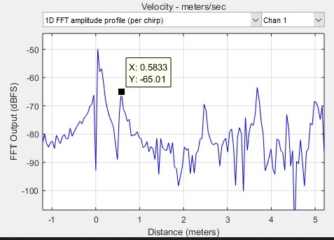

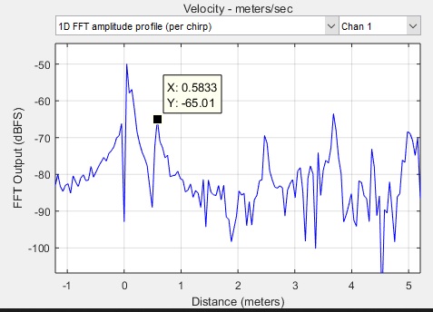

    3-  Today, I did a little experiment with TI mmwave studio. I did not use any Window operation. For a certain target and parameters configuration, I obtained the following figure:

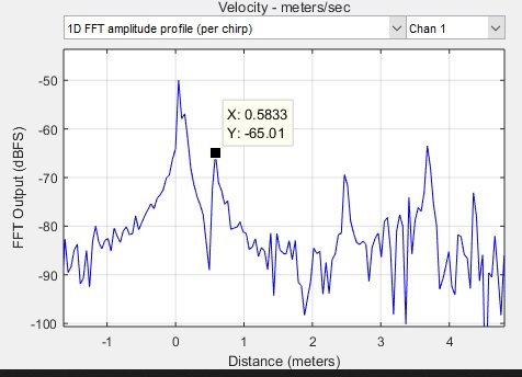

    Then, I used the "remove DC" option from the Miscellaneous options of mmwave studio and I obtained the following figure:
    I am unable to see any observable difference between the two plots except that a vertical line now appears at 0 range after removal of DC. Can you please explain this? Furthermore, I dont see that the operation defined by calibDcRangeSig of SDK is performed for DC removal in mmwave Studio.
    Are CLI command calibDcRangeSig of mmwave SDK, and, DC removal option of mmwave Studio two different things? If yes, then can you please elaborate the difference ?

    Yes, your understanding is correct. The DC removal only removes the DC from the input signal
    Answer #3
    In your experiments, after DC removal is applied , you still see a peak at short range. This is due to Antenna Coupling.
    Please see following thread for more details about DC removal implementation in the mmWave Studio matlab function
    The DC removal implemented in the mmWave SDK demo (CLI command " calibDcRangeSig ") functions as described in the demo.
