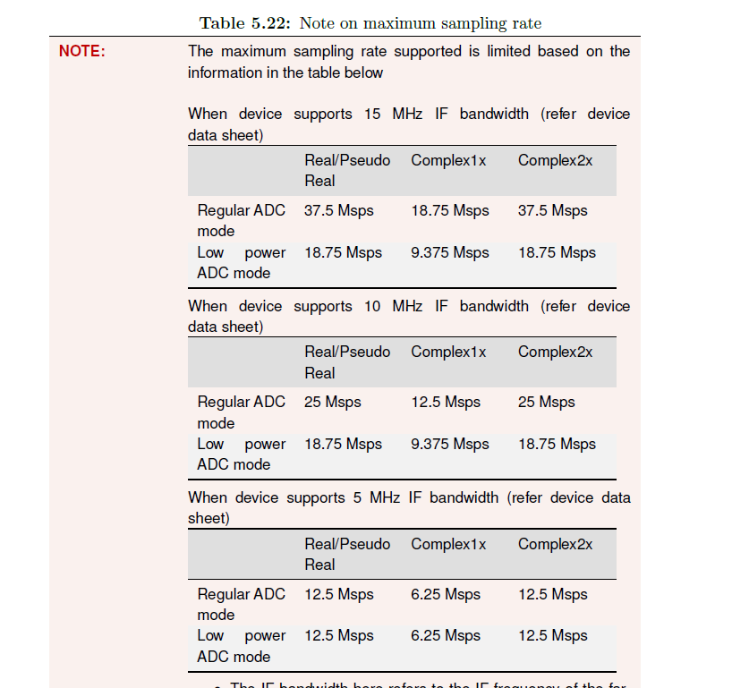

I found that if I increased the sampling rate while low power ADC was enabled, the detection distance became incorrect.
Placed the corner reflector at a distance of 8 m from the EVM, and I tested in the OOB demo.
When the sampling rate is 6Msps, a peak of 8m is obtained, but when the sampling rate is increased to 18Msps, the peak of 13m.
The cfg file used "Best Range", and only the sampling rate was changed.
Please tell me why the detection distance changes.
