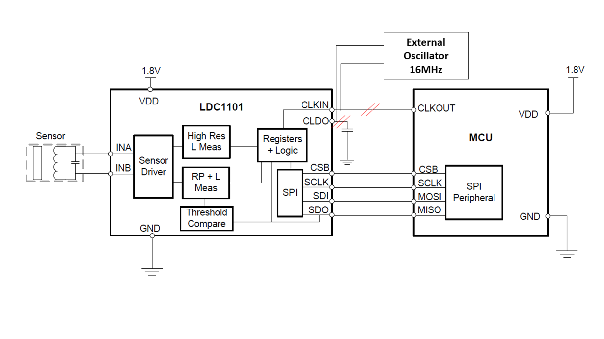

    4. One of the limitation is f_CLKIN which is now 12MHz. It can be changed up to 16MHz which should decrease conversion time by 1/4 with keeping same performance. Is default reference clock precise enough or is it only for evaluation purposes? Precision of reference clock is also one of the main component which can influence overall performance.
    Actually, I recommend using an external chip oscillator with defined jitter and temperature drift specifications. This could make a big difference in your resolution. The LDC1614EVM uses an external oscillator that may work for you, though you'd need to order it in 16MHz instead of 40MHz.
    5. I read manual snoa941a, 3 heading: In addition, the LDC1101’s LHR (High-resolution inductance mode) measurements have an effective reference frequency of 32 MHz (when the external reference frequency is set to the maximum supported 16MHz). Does the LDC1101 support even higher reference frequency then 16MHz?
    No, the maximum supported reference frequency is 16MHz.
    Are there any limitation in connecting external oscillator or I can just cut through pins in breakaway section and connect external oscillator? Will all other functionality as GUI work?
    Do you have any recommendation for already set up external oscillator? I did not find any unit in LDC1614EVM which I can use. Does TI offer such a device? Or should I just use oscilloscope as reference clock generator for lab tests?

    4. Are there any limitation in connecting external oscillator or I can just cut through pins in breakaway section and connect external oscillator? Will all other functionality as GUI work?
    As long as the LDC1101 has a valid CLKIN input the EVM should still work. You definitely don't want to cut the CLDO trace shown in your diagram though. That capacitor is needed for the internal LDO; the chip won't operate correctly without it. If you can clip just the CLKIN connection between the MSP430 section and the LDC1101 section of the board, then you can just connect your external oscillator. You may need to break apart the sections and reconnect the SPI and power connections.
    We don't make a suitable oscillator, but I do recommend using the jitter and drift specs of the CTS oscillator in the LDC1614EVM to guide your oscillator selection. You could use a function generator for lab tests with the EVM prototype, but you should expect your custom boards to behave differently when you use a chip oscillator.
