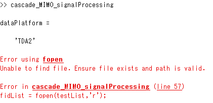

> Error using feof
> Invalid file identifier. Use fopen to generate a valid file identifier.
> Error in cascade_MIMO_signalProcessing (line 60)
> while ~feof(fidList)
How can I run this script?

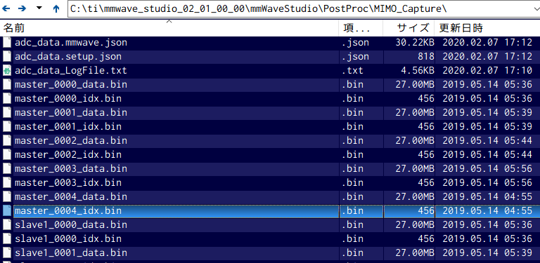

By the way, I put MATLAB scripts and adc data in the folders as follows;
MATLB scripts; C:\ti\mmwave_studio_02_01_00_00\mmWaveStudio\MatlabExamples\4chip_cascade_MIMO_example\main\cascade
adc data;
C:\ti\mmwave_studio_02_01_00_00\mmWaveStudio\PostProc\adc_data\
Are there any folders recommended?

  • Hi Hisa,
    Thankyou for your patience.
    Can you please check if the path of the "testList.txt" file is correct in your script? Line 54 takes the path of the file in the script.
    The error you're getting is mainly because MATLAB is not able to open this file.
    Ishita
  • Hi Ishita,
    Thank you for your reply.
    Setting pro path as ‘C:\ti\mmwave_studio_02_01_00_00\mmWaveStudio\MatlabExamples\4chip_cascade_MIMO_example\main\cascade\input\’, the error disappeared.

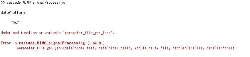

    But another error occurs as follows.
    How can I run the script?

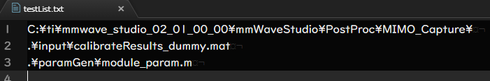

    For your information, my testList.txt and data directory are as follows;

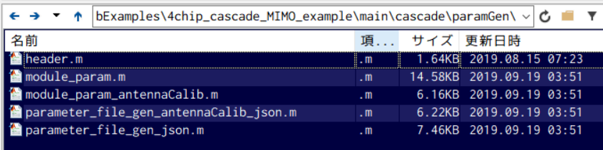

    Can you check whether the below directory has "parameter_file_gen_json.m" :
    C:\ti\mmwave_studio_02_01_00_00\mmWaveStudio\MatlabExamples\4chip_cascade_MIMO_example\main\cascade\paramGen
    Ishita
  • Hi Ishita,
    I found the  "parameter_file_gen_json.m" in the directory.

  • Hi Hisa,
    I recommend you to follow the exact step by step procedure given in section 8.3.2 of the mmwave studio cascade userguide
    Looks like you have not run "add_paths.m" previously to add all the folders to the MATLAB path.
    Ishita

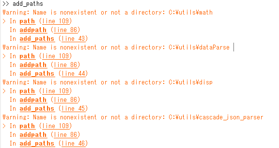

    2)     Run “add_paths.m” and some warning occur as per the below capture.

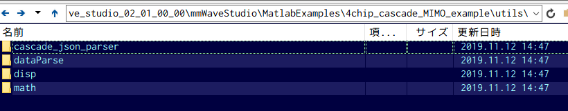

    Can you check whether there is a folder name "utils" in the following directory: C:\ti\mmwave_studio_02_01_00_00\mmWaveStudio\MatlabExamples\4chip_cascade_MIMO_example
    And if yes, it has all the below folders as well
    Ishita
  • Hi Ishita,
    Thank you for reply.
    I confirmed that there is "C:\ti\mmwave_studio_02_01_00_00\mmWaveStudio\MatlabExamples\4chip_cascade_MIMO_example\utils\" and the folder has 4 folders as follows;
    hisa
  • Hi Hisa,
    The error screenshot that you had sent previously shows that it's looking for the "utils" folder in the wrong directory.
    The correct directory is already identified by you in your previous reply. It might be possible that your environment variable is not created successfully. Can you update the Home directory in the add_paths.m script and try again.

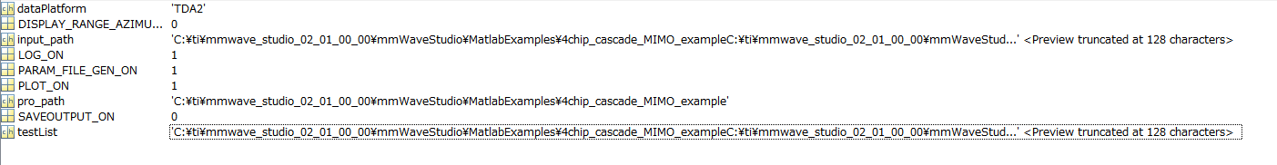

    I'm trying to run cascade_MIMO_signalProcessing.m, and  an error occures;
    The values of parameters are as follows;
    It seems testList contains two paths. Is this correct state?
    hisa
  • Hi Hisa,
    Yes you're right, follow the user guide and make sure the path of the testList.txt file is correct.
