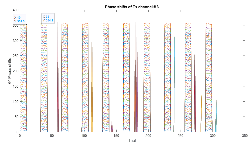

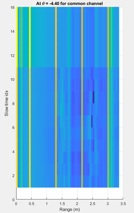

I am trying to configure the radar for 192 different chirps for each chip and repeat them 32 times in a burst in a subframe of the advanced frame. Also, these chirps have unique phase shifts by adjusting the Tx phase shifter for each Tx. From "Programming chirp parameters in TI radar devices.pdf section 6" and from the "radar interface control" of  "mmwave_dfp_01_02_05_01" table 5.26, I understood that one can define up to 512 different chirps that they can be iterated up to 512 times in a burst. Thus, we can have up to 262144 chirps in frame. However, when I investigated the received chirps I realized that only the first 10*192=1920 chirps have the specific phase shift values that I set for each chirp. Why? What does limit the number of different chirps with different phases?
