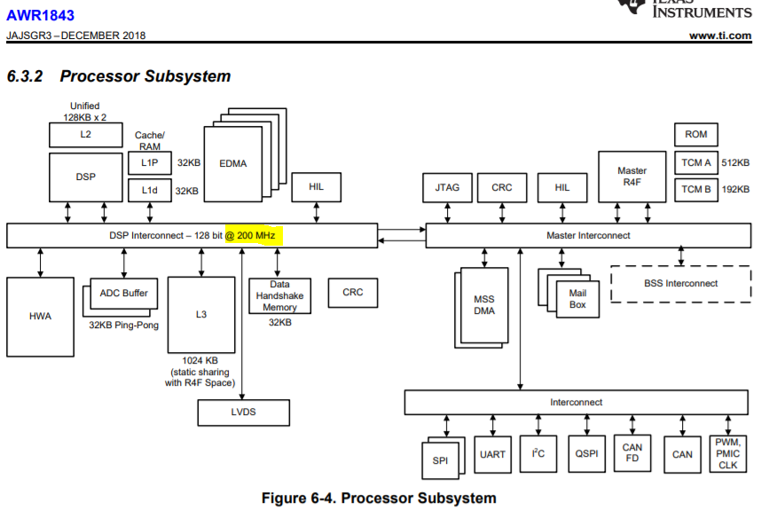

What is the Primary SCR (64bit) bus clock?
The SCR (128bit) is described as 200 MHz, but I cannot find the description of the Primary SCR (64bit) bus clock.
Hi Kensuke,
By Primary SCR do you mean the master interconnect bus? That is 64 bits and running at 200 MHz.
