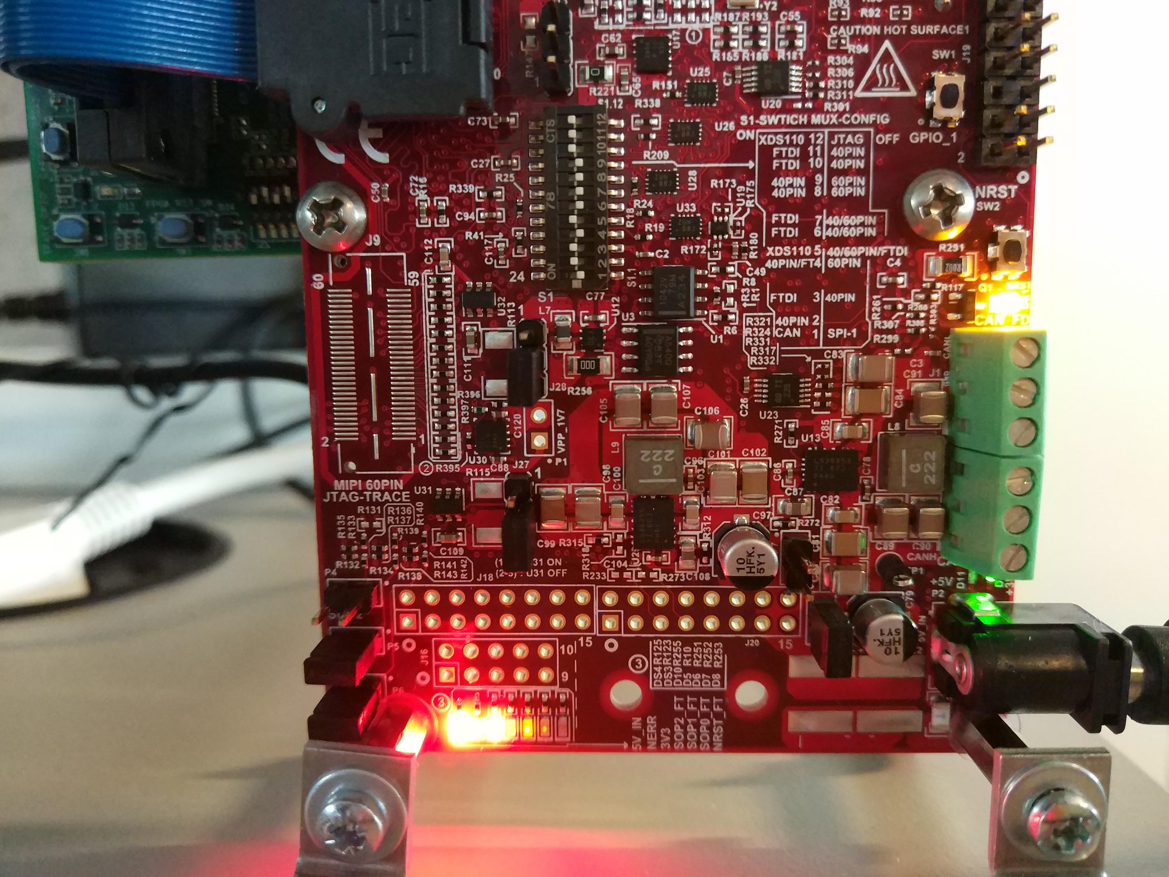

DCA1000EVM: Timeout Error! System disconnected, error : The number of files captured is zero!
Part Number: DCA1000EVM
Other Parts Discussed in Thread: UNIFLASH, IWR6843,

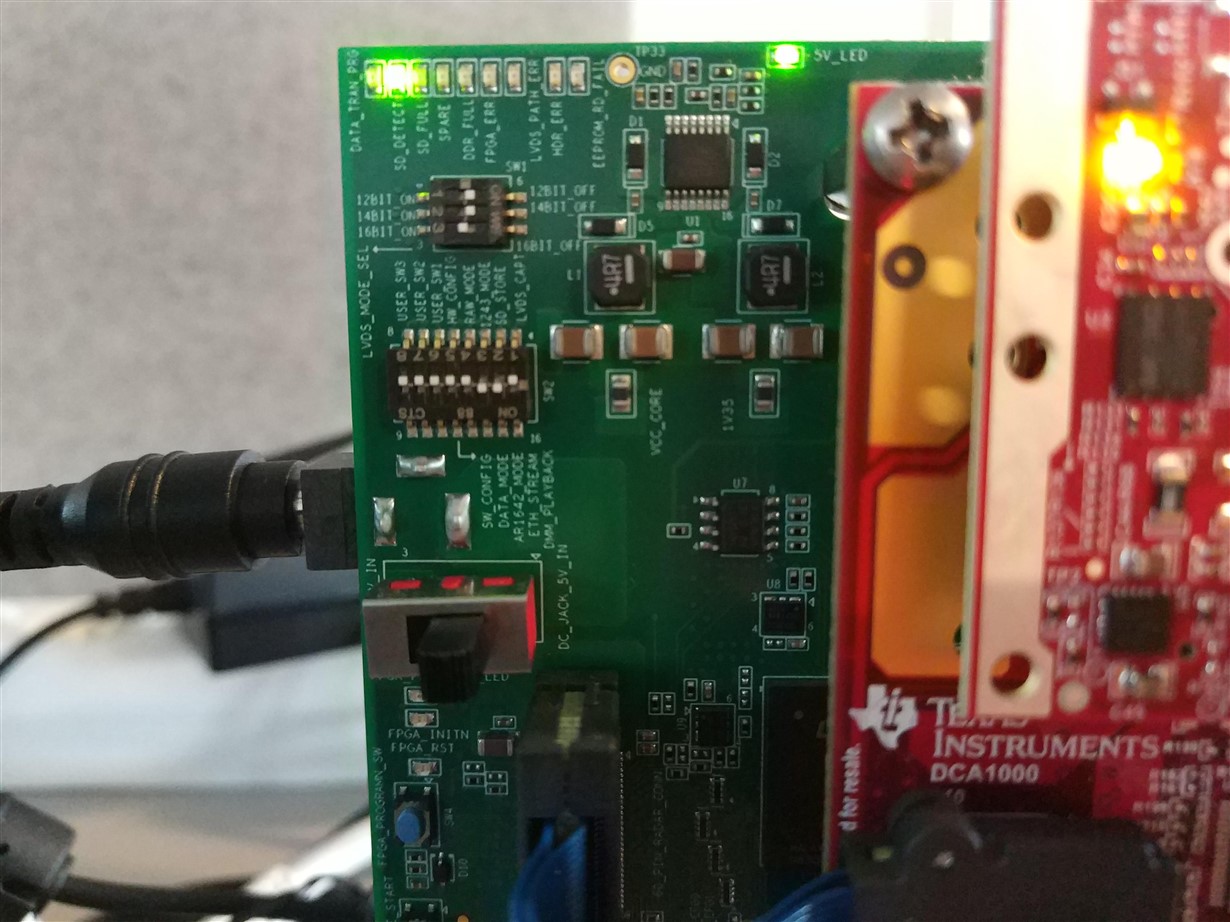

It seems that the following thread  has been closed but we are still facing the same issue. Together with Thomas Solignac, we're trying to acquire raw data from a DCA1000 evaluation board. We've followed the TI documentation to install mmWave Studio (mmwave_studio_02_01_00_00_win32), Uniflash (uniflash_sl.5.2.0.2519) , third party libraries (MCR_R2015aSP1_win32_installer,  LVRTE2014SP1_f11Patchstd) and as you can see in the following screenshots, the SW/drivers seems to be well installed/configured:

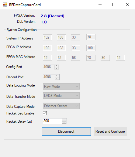

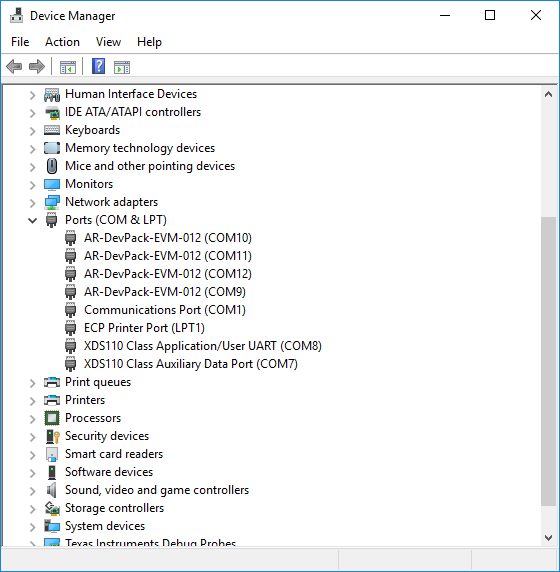

We can connect to the device and everything seems to be ok as well:
After setting the different tabs (StaticConfig, DataConfig, SensorConfig tabs), we Set Up DCA 1000 and we connect (we've followed your advice and we have set the pack delay at 300us):
However, nothing happens when we trigger a frame and after approximately 1 minute we got the following error message:

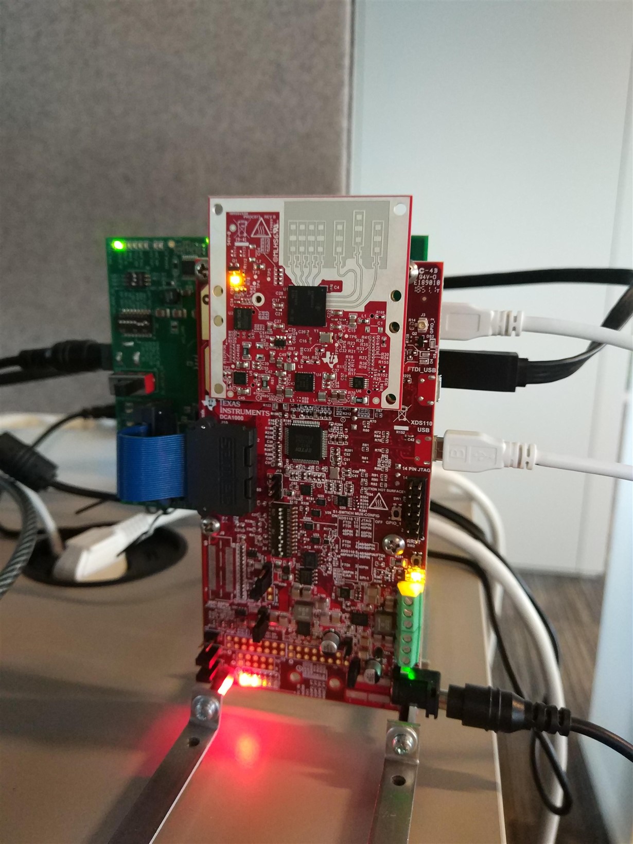

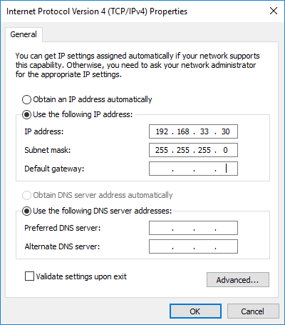

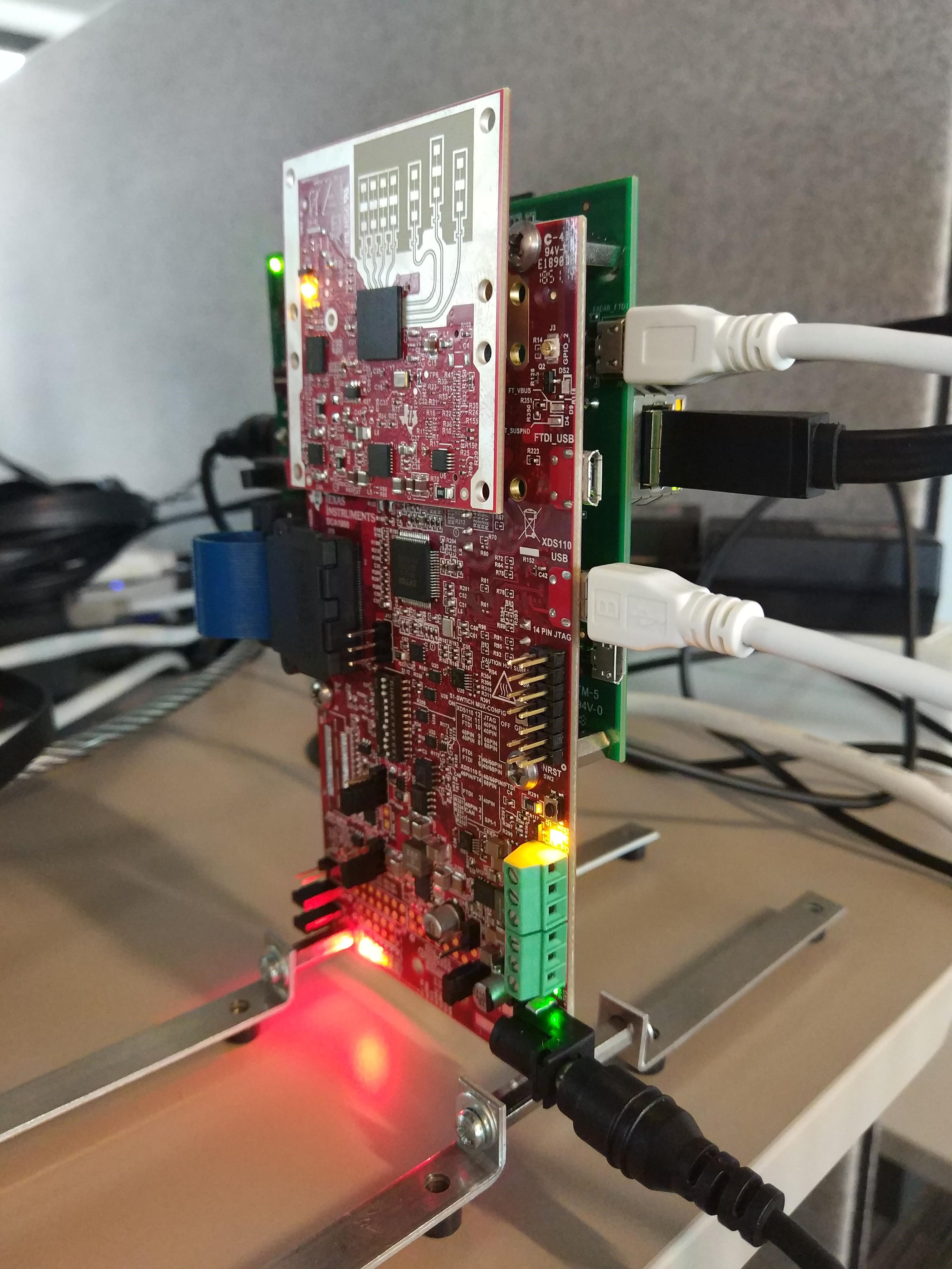

We've tried the following:
  1. Run different computer with differnt OS, e.g., Windows 7 and Windows 10.
  2. Run mmWaveStudio with administrator rights
  3. Dissable firewal (ESET Endpoint Security)
  4. Add exceptions (trusted zone) to IPs 192.168.33.30 and 192.168.33.180
  5. Disable WIFI, or run in airplane mode
  6. Plug the Ethernet cable directly to the Ethernet connector of the board
  7. Use differnt Ethernet to USB adapters
In 6 and 7, we've always fix the IP as follows:
But in all cases, we always get the TIMEOUT error.

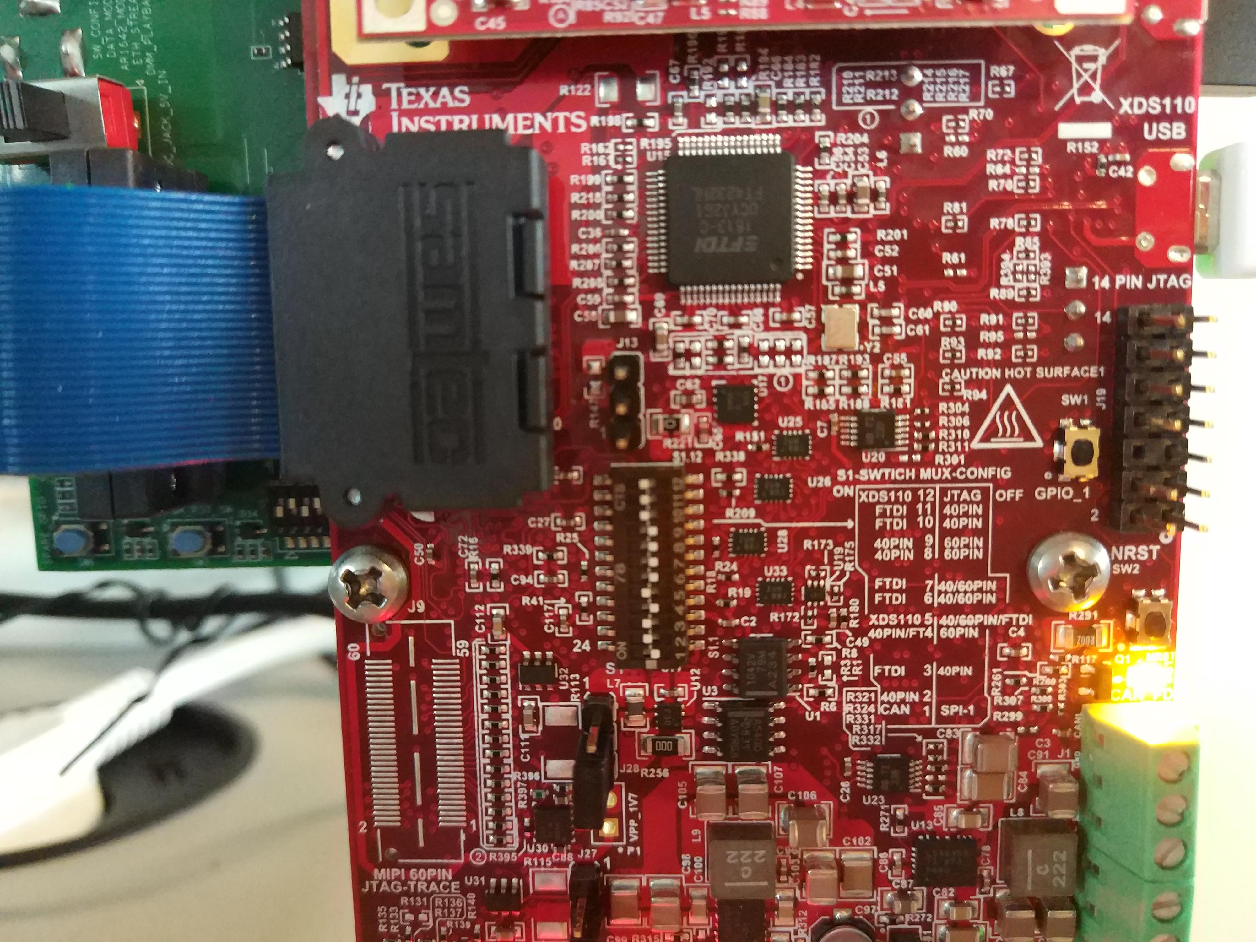

We now wonder if the error could be linked to the hardware itself, or to the pinout configuration?
Please, find next the log file:
