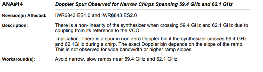

When i set the IWR6843 into CW mode output, and the radar output 61GHz cw signal.
but always it has some spur move around the signal just like the video, all the frequencys is the same.
i confirm the enviorment do not have this spur and the demo board of ODS also has the spur just like my board.
So could you give me some advices?
my config file is :
sensorStop
flushCfg
dfeDataOutputMode 2
contModeCfg 61 0 0 2600 0 0 30 0 1024
channelCfg 15 1 0
adcCfg 2 1
adcbufCfg -1 0 0 1 1
sensorStart
