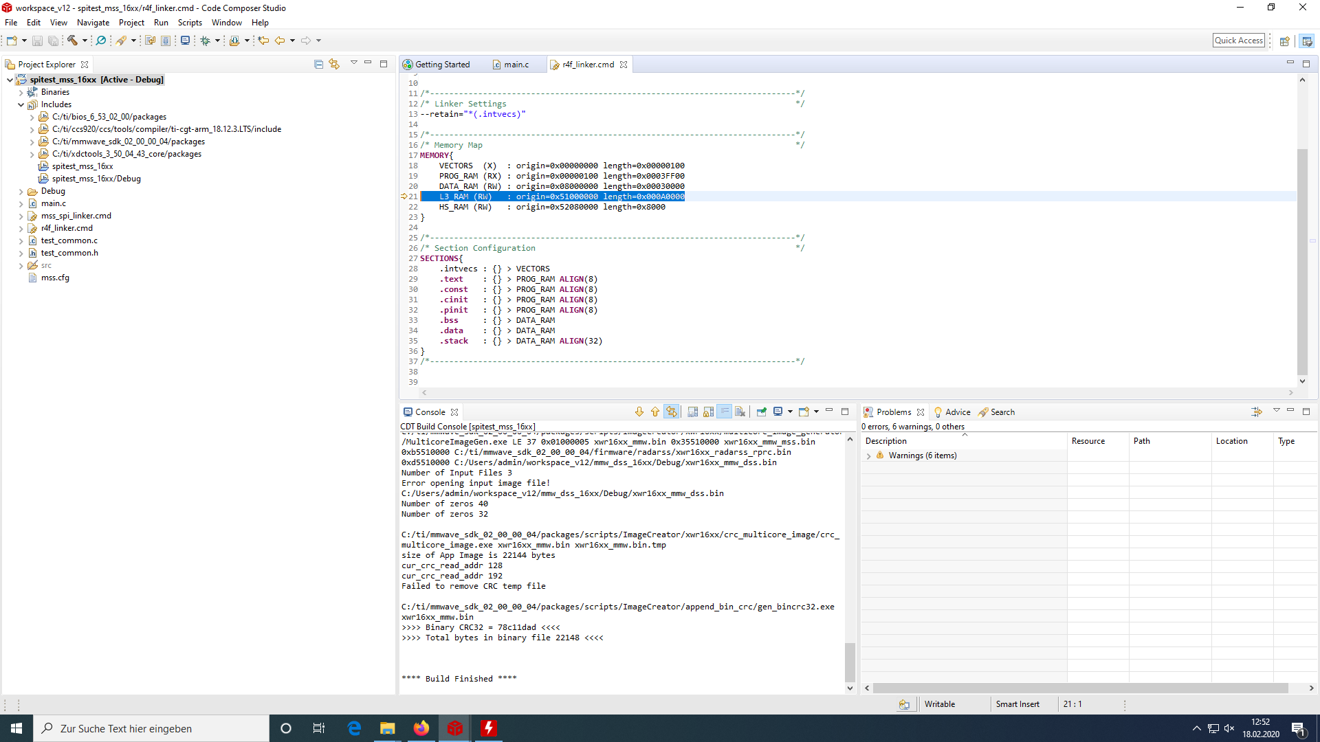

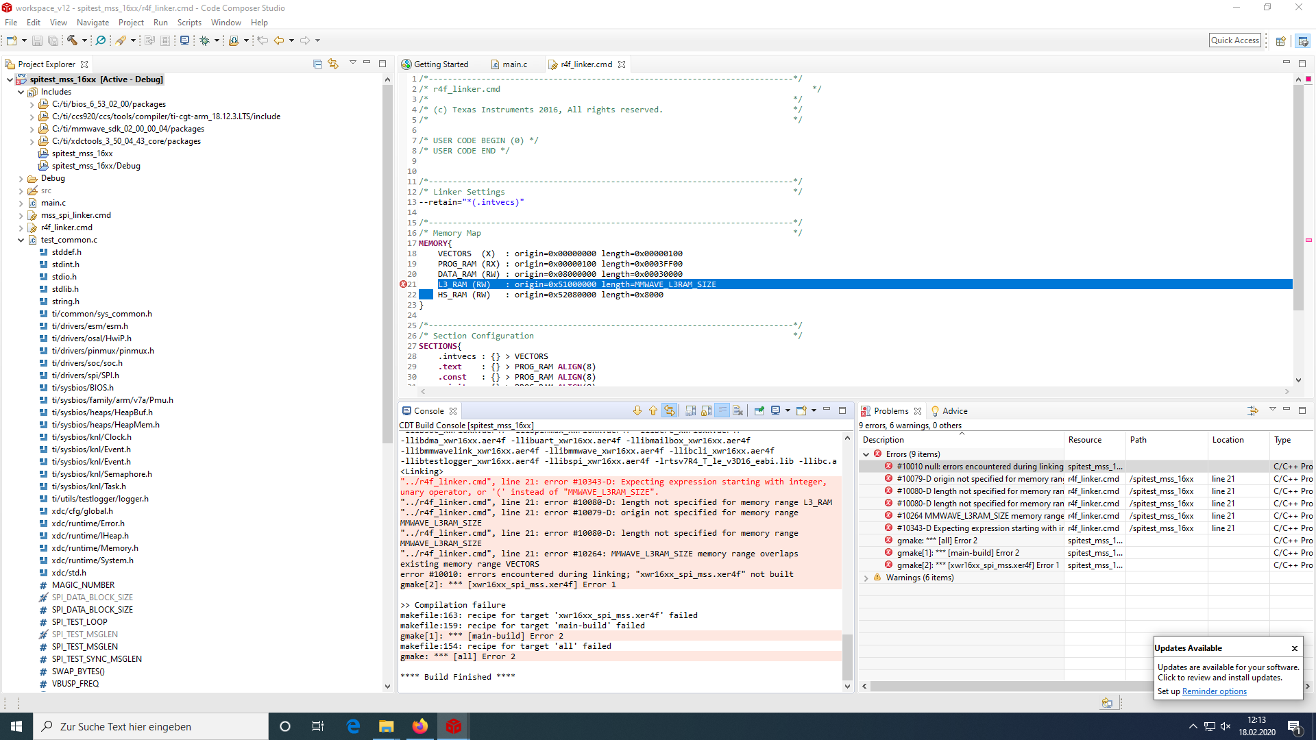

After Importing the ProjectSpec and rebuilding it I get some Errors as seen in Picture 1. After solving these by replacing the MMWAVE_L3RAM_SIZE Define with an actual Integer Value I have found in several other DemoProjects(as seen in Picture 2) the Code is running without any Errors... But as soon as I flash the Code to my IWR1642_BOOST DS1 does glow red. (This should indicate an actual HW Error) Is this caused due to my change I have made to the MMWAVE_L3RAM_SIZE? Or do I have some other issues with this Software/my Hardware?
