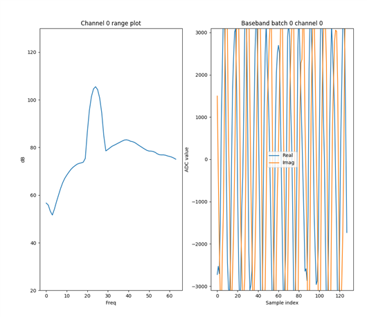

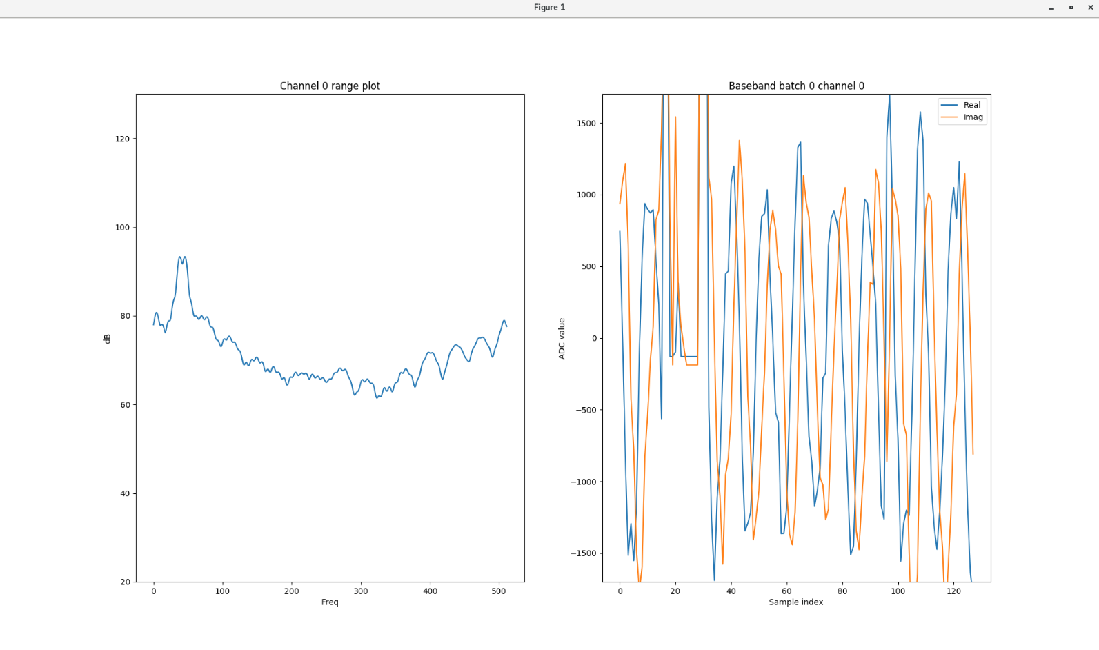

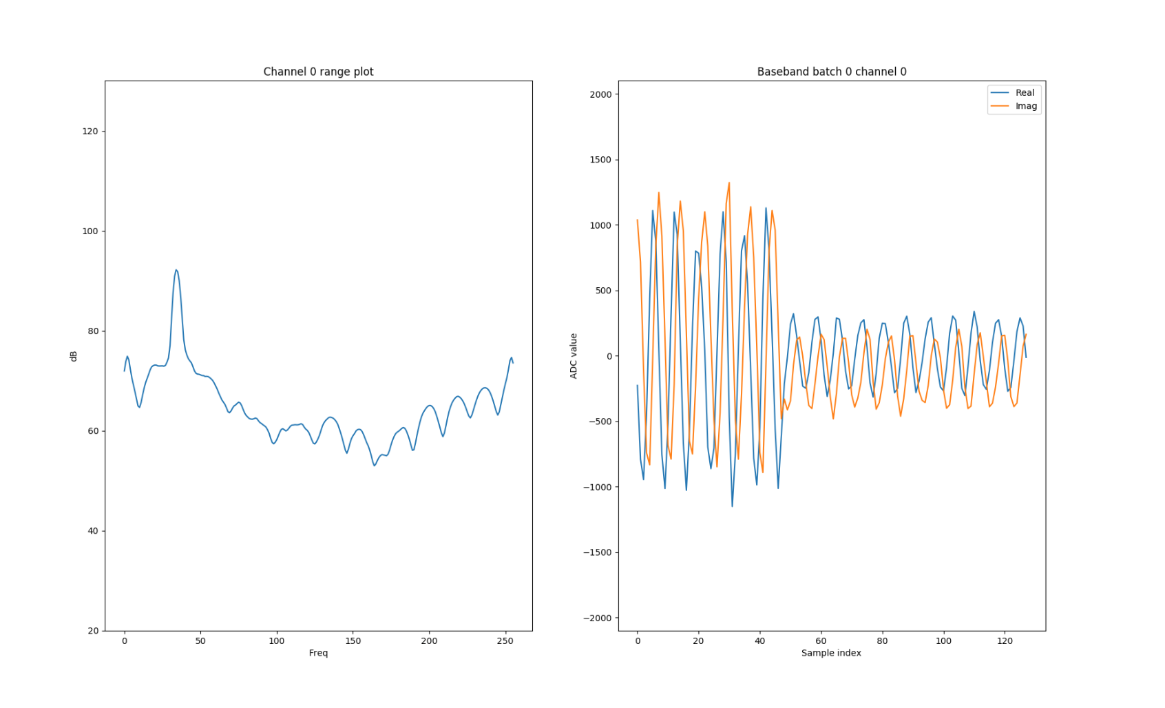

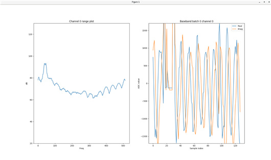

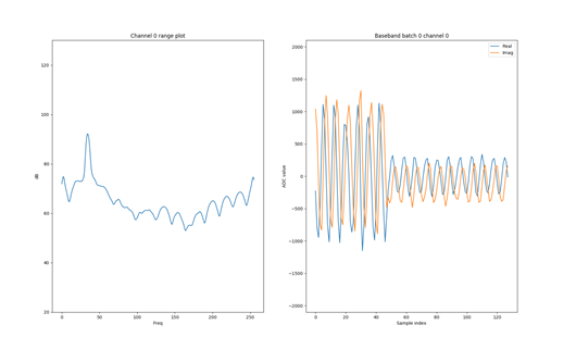

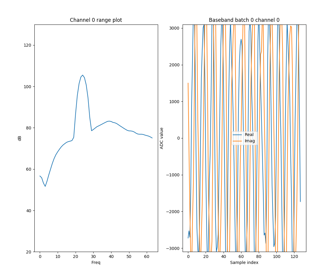

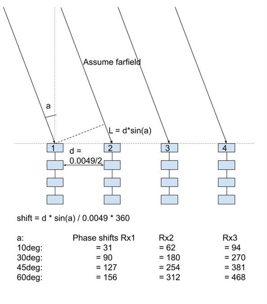

I am still trying to extract the phases of the individual Rx antennas.
To do so, I have two antennas, running CW:s at a certain offset facing each other.
I have a dca1000 connected to one IWR6843 reading out the ADC raw data from it while in CW mode (we have this working)
but when looking at the baseband the data looks to odd.
It look like sometimes the data is a mix of two different chirp data, see image. I am expecting one good looking sinus wave.
I have tried enabling the HSI header to mark the beginning of every frame but this does not seem to help.
Can you point me in any direction of how to find out why the data looks broken?
Here is some code creating the plots (Python)
    r_win = np.blackman(conf['n_samp'])
    for frame_index, data in data_loader.read_frames():
        cube = data['cube']
        cube -= np.mean(cube, axis=0, keepdims=True)  # remove DC
        r_cube = np.fft.fft(cube * r_win.reshape(-1, 1, 1), axis=0, n=conf['ran_n_fft'])
        # incoherent integration in doppler to improve SNR
        dop_result = np.mean(np.abs(r_cube), axis=1)
        plt.clf()
        plt.subplot(121)
        plt.plot(20 * np.log10(np.abs(dop_result[:, 0])))
        plt.title('Channel 0 range plot')
        plt.ylabel('dB')
        plt.xlabel('Freq')
        plt.ylim(20, 130)
        plt.subplot(122)
        plt.plot(np.real(cube[:, 0, 0]), label='Real')
        plt.plot(np.imag(cube[:, 0, 0]), label='Imag')
        plt.title('Baseband batch 0 channel 0')
        plt.ylabel('ADC value')
        plt.xlabel('Sample index')
        plt.legend()
        plt.ylim(-2100, 2100)
        plt.pause(0.01)

  • The two different IWR6843 might drift but that does not matter in my setup.
    All that matters is the raw adc data output from the DCA1000 from one of the boards. It should be one single sinus wave if I understand it correctly, but it looks to me that the data I see is either scrambled or data from two different chirps and the broken part of the wave in the plots (right subplots) is where one chirp begins and the other ends.
    The two plots are of the same setup at two different points in time.
    The left plot is the result of the FFT and the right one the real and imaginary part of the raw data for the first chirp from Rx0.
    I am trying to extract data to be used to see the phase difference for the 4 Rx:s. After processing the data, I expect something like the image (using Rx0 as reference with a phase shift of 0 degrees).

  • Thanks for your input.
    We figured out that the data was broken by the DCA1000. Too much data in to little time it seemed.
    We solved it by resetting the DCA1000 connection for every measurement and reading and discarding 5 frames before taking the measurement data from the DCA1000.
    This resulted in good looking baseband plots.
    We will continue on to use this data to calculate the phase differences of the different Rx antennas now.
