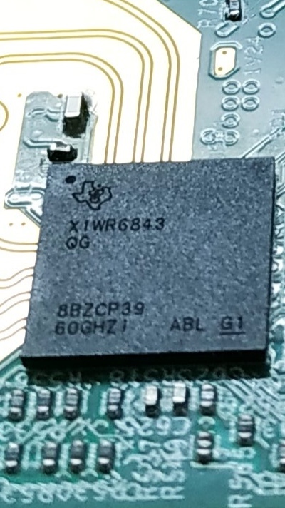

We are successfully building and running C:\ti\mmwave_industrial_toolbox_3_6_2\labs\lab0015_pplcount_68xx on our platform.
I am trying to get SBL working on our board IWR6843. We are trying to boot the same image with the below SBL images and both showing same issue. I followed the steps given in SBL_design.pdf.

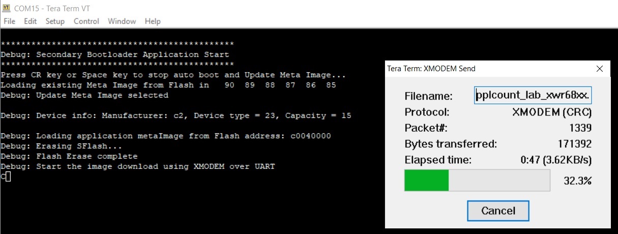

issue 2: I flashed only SBL and it boots successfully in the next power reboot. I successfully uploaded the image from Teraterm XMODEM send option. The image got successfully downloaded in to flash. But the image got stuck at "Parsing Completed" message. The main image is never booting. Please see the SBL log where the main image is downloaded successfully from Teraterm XMODEM transfer. The next reboot again going to SBL and got stuck at "Parsing Completed". Please check the below log.
Debug: Secondary Bootloader Application Start
Press CR key or Space key to stop auto boot and Update Meta Image...
Loading existing Meta Image from Flash in   90  89  88  87  86  85
Debug: Update Meta Image selected
Debug: Device info: Manufacturer: c2, Device type = 23, Capacity = 15
Debug: Loading application metaImage from Flash address: c0040000
Debug: Erasing SFlash...
Debug: Flash Erase complete
Debug: Start the image download using XMODEM over UART
CDebug: Total data written = 0x81680
Debug: Parsing completed
<SBL got stuck here>
<Manual NRST pin is pressed>
Loading existing Meta Image from Flash in   90  89  88  87  86  85  84  83  82  81  80  79  78  77  76  75  74  73  72  71  70  69  68  67  66  65  64  63  62  61  60  59  58  57  56  55  54  53  52  51  50  49  48  47  46  45  44  43  42  41  40  39  38  37  36  35  34  33  32  31  30  29  28  27  26  25  24  23  22  21  20  19  18  17  16  15  14  13  12  11  10  9  8  7  6  5  4  3  2  1
<Again SBL got stuck here>
