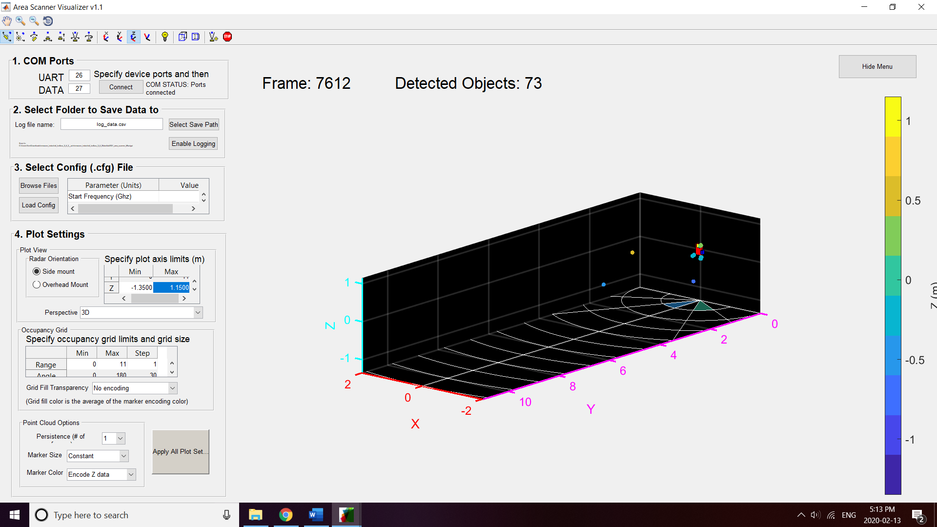

Now that I have gotten the Area Scanner GUI (Industrial Toolbox 3.6.2) working, I have a new problem. I can only get it to detect me when I am motionless at a distance of 3 meters (at 0 degrees azimuth). After this there are no points in the GUI. When I am moving, it will detect me at around 5m. I am using IWR6843ISK-ODS with MMWAVEICBOOST. The firmware on the chip is toolbox \mmwave_industrial_toolbox_4_2_0__win\mmwave_industrial_toolbox_4_2_0\labs\out_of_box_demo\68xx_ods_point_cloud_demo\prebuilt_binaries. The chirp config is \mmwave_industrial_toolbox_4_2_0__win\mmwave_industrial_toolbox_4_2_0\labs\out_of_box_demo\68xx_ods_point_cloud_demo\chirp_configs
This is unexpected because the chirp config has max distance 9.62m. I restarted the demo with no success. I tried some other chirp configurations without success. Do you know why it only sees 3m away? I've attached a picture of the result of me standing at 3m. Even there it has trouble finding points.

    With the 3.6.2 Visualizer I tried modifying the CFAR function in the config. I tried 5 and 10 dB. At these values it detected me at slightly farther distances, with more points detected, but once I was past 5m neither of them saw me. I also tried 0dB but with that value the demo froze. Even with holding a metal sheet in front of myself I couldn't get past 5m. Do you think that the range is limited by the SNR? The radar is mounted at 1.35m above a concrete floor in a large room with no clutter nearby. Have you ever gotten this radar to detect 3D points beyond 5m?

    You were right about the 4.2.0 Area Scanner: I was using the wrong binary. But after working extensively with this setup and reading documentation, I still can't get static detection past 3.5m. My requirement is 5m. What do you think is the maximum possible range? The only other example I have of this demo is the video in the user's guide, where it's not clear to me if it statically detects beyond 3.5m.
    My setup is:
    - 4.2.0 Area Scanner GUI
    -4.2.0 Area Scanner ODS prebuilt binary
    -4.2.0 Area Scanner ODS chirp config
    - MMWAVEICBOOST
    - IWR6843ISK-ODS.
    My demo settings are:
    I tried changing several parameters in the CLI commands in the config file.
    Like you suggested, I first tried changing the SNR threshold in the cfarCfg command. According to the SDK documentation, the second parameter in cfarCfg indicates if it is for the range or the doppler direction. I changed the threshold down to 5dB for the range direction (procDirection=0), and this did not work. The static detection still couldn't detect anything past 3.5m, however the dynamic points became a lot more common. (I also tried lowering the threshold for the Doppler direction, procDirection=1, but that didn't help either)
    Another parameter I tried changing was in clutter removal. I changed the second parameter from 1 to 0, to turn off clutter removal, and this didn't change anything either.
    Next I tried playing with the parameters in staticDetectionCfg. I couldn't find documentation for this command so I had to guess based on the comments in the function MmwDemo_staticDetectionConfig in the file mmw_cli.c, which I assume is the parser for this cli. I tried raising and lowering the local peak threshold, heatmap different threshold, and significant threshold. Regardless of what I did, the static detection range did not pass 3.5m.
    I attached a picture of my setup, in case you can identify anything that would be affecting my range.
    Thank you for your help,
    Tom
