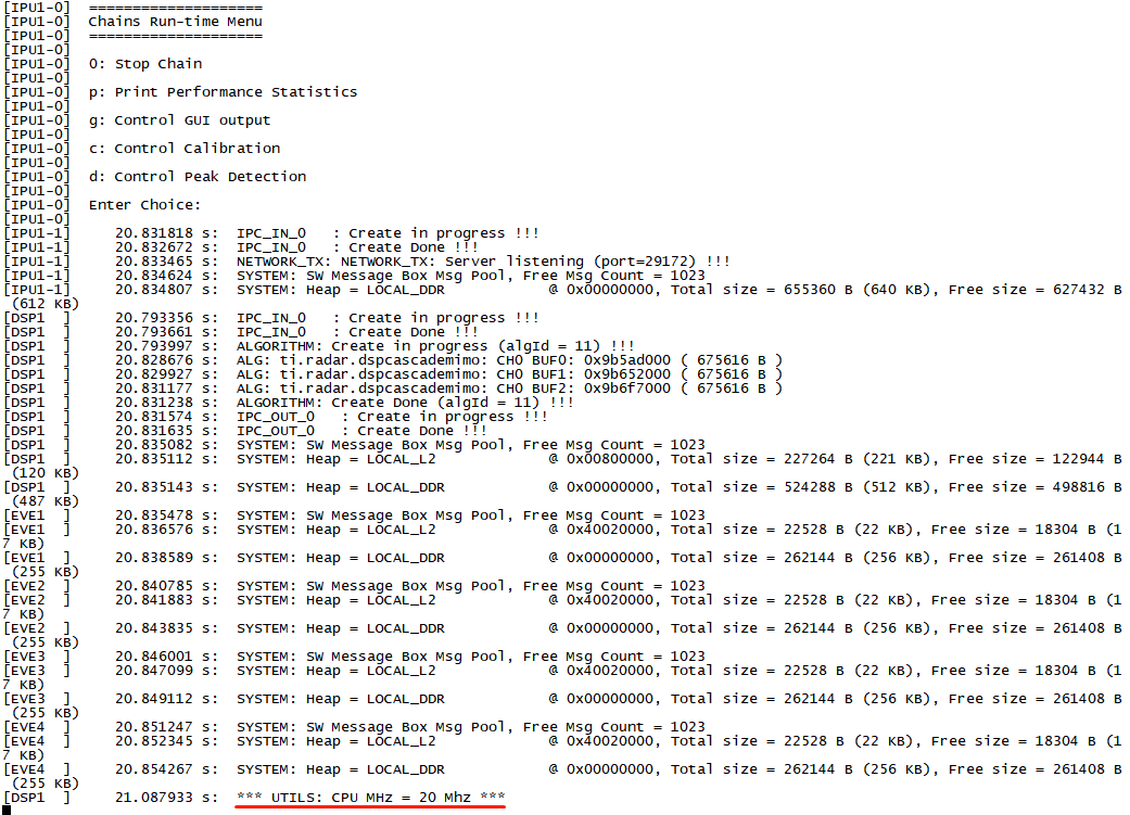

After that, there is a high probability that the last line shown below will not be printed:
At this point, part of the radar code can work normally, but the AlgorithmLink_radarProcessProcess() function in
C: PROCESSOR_SDK_RADAR_03_07_00_00\vision_sdk\apps\SRC\rtos\radar\SRC\alg_plugins\radarprocesslink_algplugin.c
will not be executed, so the radar does not work normally.
If I keep rebooting the radar, eventually
*** UTILS: CPU MHz = 20 MHz ***
will be printed and the radar will working normally.

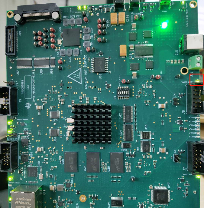

  • On the back of the cascade processor board, there are 4 LED lights with labels such as "FPGA1 CDONE", "FPGA2 CDONE", "FGPA3 CDONE", and "FPGA4 CDONE".
    When the board is not working, could you check if those LED lights are ON?

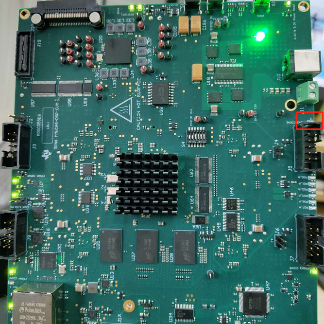

  • The "FPGA2 CDONE" light did not on when the radar is not working:
    And if this light is on,  the radar will be working everytime:
    So that's probably why. What should I do to solve this problem?
    thank you very much.

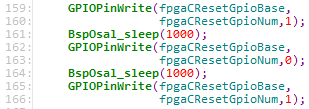

  • I changed all of the BspOsal_sleep(100) to BspOsal_sleep(1000),  there are four places:
    and I wrote this:
    So I can confirm that the code was successfully modified.
    But the problem remains...Is there any other way to avoid this problem?
    I really need to solve this problem as soon as possible. Thank you very much.

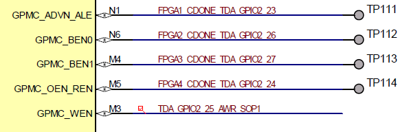

    At the moment, I would suggest you to implement a check for FPGA CDONE signal which indicates if FPGA is functional after reset. If not, simply stop the use case and reboot the board.
    From the schematics, you can see GPIO2_23/GPIO2_26/GPIO2_27/GPIO2_24 are connected to 4 FPGA CDONE signals repectively.
    You can read the status after the FGPA reset is released.
    If CDONE doesn't go high ('1'), the FGPA will not be functional.
    At this point, you can stop the use case and reboot the board.
