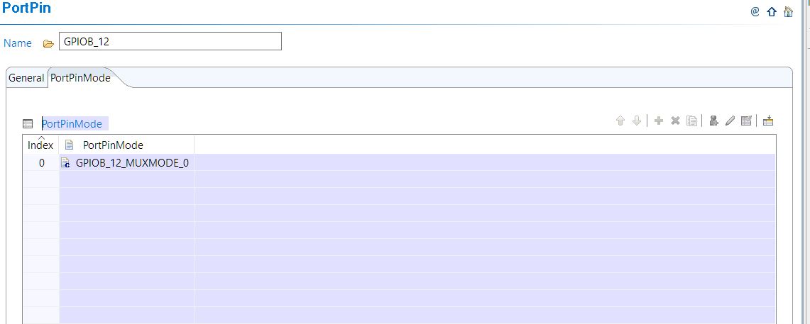

we want to configure the TI MCAL (1.04). But the Pin P13 is not selectable as GPIOB_12 on AWR1843. The Port module for the AWR1642 does not have this issue. Am I missing something?
I compared the configuration files for EB Tresos and it appears that there is no GPIOB_12 for the AWR1843:
Why is GPIOB_12 not selectable?

  •  sorry, this image got lost I think:
  • Hi Christoph,
    By default the P13 is chip select for MIBSPIB ie  "MIBSPIB_CS"  .
    If you delete the MIBSPIB_CS option from the MIBSPIB container then you will be able to configure the P13 for GPIOB_12.
    -Raghu
  • I expected that already, so I removed whole MIBSPIB definition within the Port module. Still, GPIOB_12 is still not possible

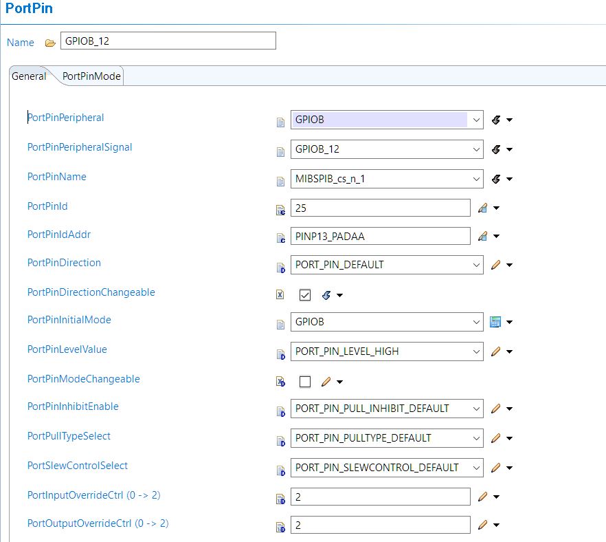

  • Hi Christoph,
    Please find the snapshot of the successful configuration that was generated on Tresos for the GPIOB_12 after deleting the MIBSPIB_CS
    What is the error you see?

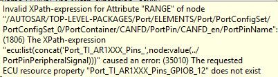

  • Hi Christoph,
    We do not have any parameter CANFD_en not sure why you are getting this error. Do you have any custom modification done in the plugin?
    BR,
    Raghu
  • Hi Raghu,
    we are on a custom board and therefore I added a new Pin to the CANFD parameter set. This is standard procedure in Tresos.
    Kind regards
    Christoph

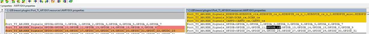

  • Here is our patched AWR18XX.properties file. With this, we can drive the GPIO12 pin without any problem. Please confirm that this patch has no sideeffects and there is indeed a problem with the plugin and not in our project configuration.

    Port_TI_AR1XXX_Signals_GPIOA:GPIOA_0,GPIOA_1,GPIOA_2,GPIOA_3,GPIOA_4,GPIOA_5,GPIOA_6,GPIOA_7
    Port_TI_AR1XXX_Signals_GPIOB:GPIOB_10,GPIOB_11, GPIOB_12, GPIOB_13,GPIOB_14,GPIOB_15,GPIOB_8,GPIOB_9

    Raghu
