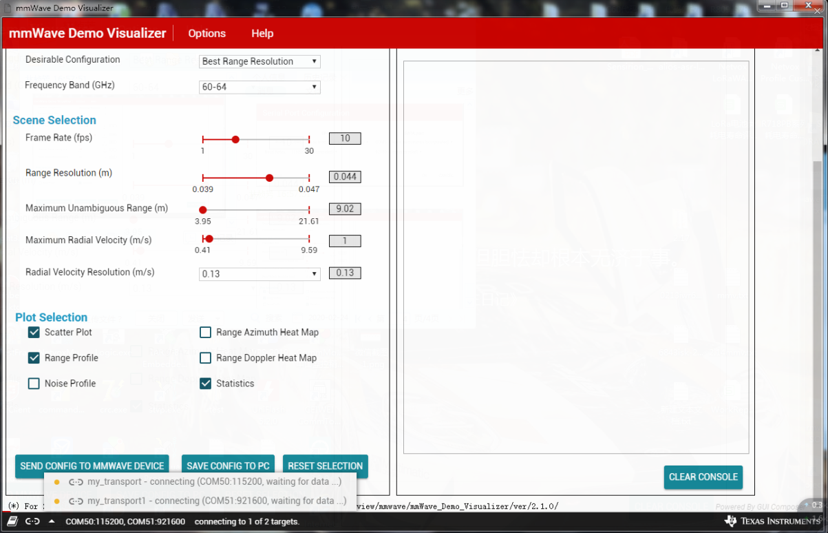

Hi there,
I am unable to connect my IWR6843ISK to the demo visualizer.I am able to use uniflash to flash the pplcount lab xwr68x.bin file of iwr6843isk in the lab, and then use the pplcount gui.exe program to get the point cloud map.During the setup of the IWR6843ISK i have correctly using the correct serial port. But whenever i press "send config to the mmwave device" it will show that com port 50 and com port 51 is "waiting for data". I hope I can get help, thank you very much, looking forward to your reply.
Thanks.
    You are using the wrong visualizer. Please read the manual.
    Justin

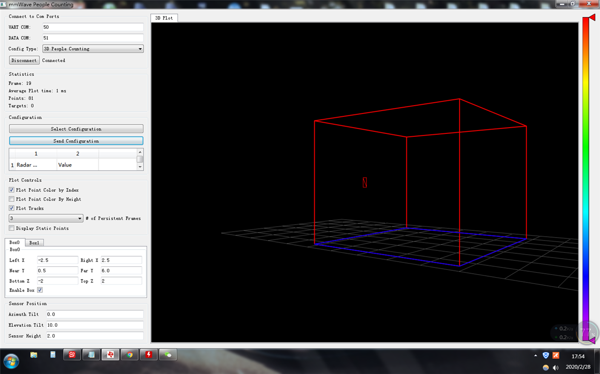

  • Hi,Justin .
    I really need your help.
    I tried to rebuild the.bin file using Code Composer Studio 8.1.0 or reinstall the toolkit, but still could not get the image data correctly.
    This time I chose the configuration document, but every time I pressed the "send configuration" button, the visualizer failed to respond.
    thanks!

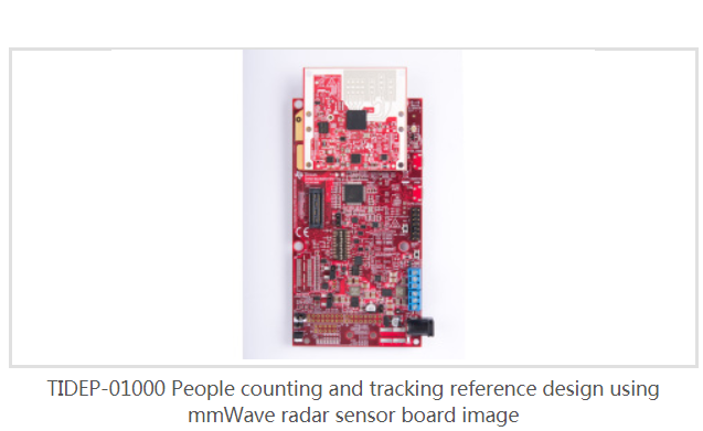

  • Hi,Justin .
    I want to use IWR6843ISK EVM flash tida-010022 pc_lab_xwr68xx.bin file and run it successfully on the device, hoping to solve the following two problems.
    1. Which visualizer should I use to observe the trajectory and point cloud map of the human body?
    When I used mmwave_people_counting_guisetu.exe, the result was the same as before, even without the GUI.
    2. Can use serial port tool to send commands, configure relevant parameters, start sensors and read data.
    Is there any relevant document for reference?

    I can think of a few potential issues:
    1. The com ports you have entered may be flipped.
    2. The computer is blocking access to the com ports, so that the gui application cannot use them. This is common with unregistered software, and can usually be fixed by running as admin.
    3. The wrong configuration is being sent (I think you already confirmed you were using the correct configuration and setup)
    To use the TIDA-01022, please download an older version of the toolbox. Version 4.0.0 is best. You can select different version of the toolbox from the TI Resource Explorer page. Once you have this, run lab "68xx_people_counting" - this is the same software used in TIDA-01022. This comes with a Matlab gui - see if this one works for you.
    Justin
