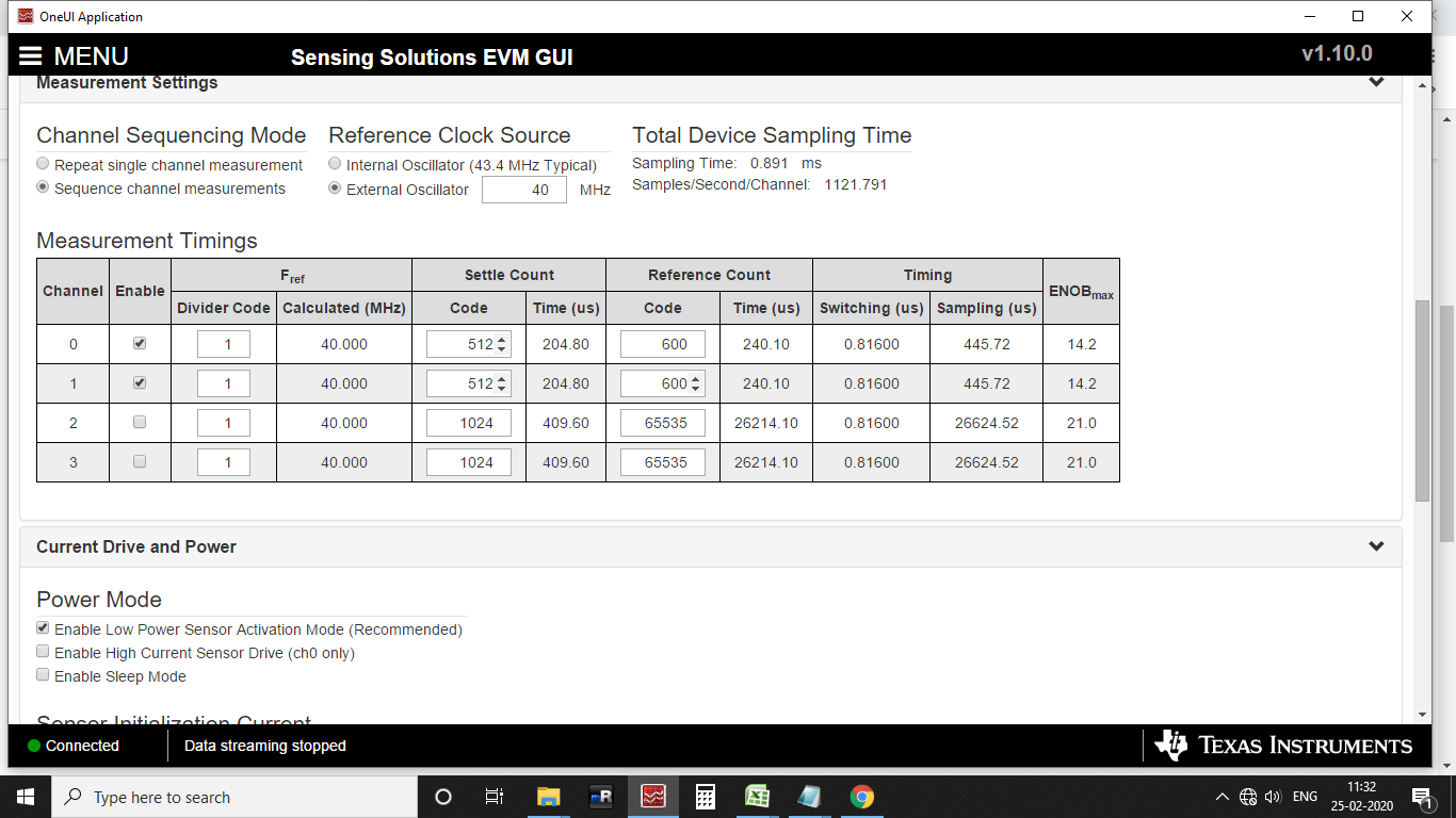

I have an issue with the sampling rate. please help
Samples/Second/Channel: 1121.791
but in O/P we are not getting these sample rates How to fix these issues.
Hello Shivam,
You can use the GUI to change the sample rate of the LDC1614, but you can't change the rate at which the MCU reports samples to the GUI. It's still useful to change the sample rate of the LDC1614 to measure your resolution. If you need access to all of the samples you'd need to write your own code to communicate with the MCU directly. We have sample code in this FAQ.
