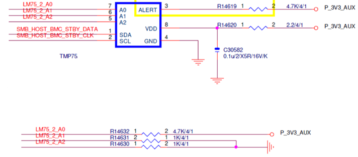

Hi expert,
As titled, customer found the sensing on their board the value is wrong, read back via I2C.
Passing case is high 85 - low 75
Fail is high 0 - low 3
Even try to overwrite this register value, but read back the value after update, the value is not changed
Do you have any idea with this?
From the schematic, also I found there's a 2.2ohm not k, pull up to VCC
