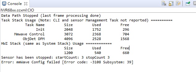

  • Hi Zigang,
    Please see the reply below.
    complete configuration:

    error message:
    Data Path Stopped (last frame processing done)

    Sensor has been stopped: startCount: 3 stopCount 3
    Error: mmWave Config failed [Error code: -3108 Subsystem: 39]
  • sorry!
    about : error message:
    After copying and pasting. Some problems
    So i attach the picture.
  • Your new profile has changed the ADC rate from 2400 to 1200.   The lowest ADC rate is 2000.
