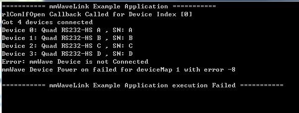

    I tried to connect all the interfaces that ftdi can export to AWR1243,then ran mmwave_example.exe ,it got 4 devices connected but  still shows mmwave device is not connected at first,return error-8 and couldn't call Poweron API. I listed my steps, did I miss anything?
    1.I have an AWR1243BOOST and an FTDI development board with an FT4232H chip onboard. The development board has all the pins of the ftdi chip.
    2.I found the position of the functional pins corresponding to ftdi according to the schematic of mmwave-devpack. For example, the SPI pins are ADBUS0 ~ 3, and the SOPs are DDBUS2 ~ 4. . .Then I connected all FTDI pins to J5 and J6 20-pin LaunchPad connectors on the back of AWR1243BOOST,including SPI,nreset,nerror,IRQ,SOPs,5V/3.3V VIO,and any other like what the FT4232H on the mmwave-devpack did.
    3.I ran mmwave_example_nonos.exe,and it shows the error I mentioned above(also tried mmwave_example and mmwave_monitoring)
    Junzhe

    I've tried delete FTDI drivers and update them to ones mmwave-studio 02_00_00_02 provided. Devices are listed like this
    But when I ran mmwave example,it still showed mmwave device is not connected like this:
    Junzhe
  • Hello Junzhe,
    if you are using the DFP example then the FTDI ID also needs to be set to what the library is looking for. This can be done by flashing the attached xml to the FTDI using the FT prog tool available on the FTDI website.
    Vivek
