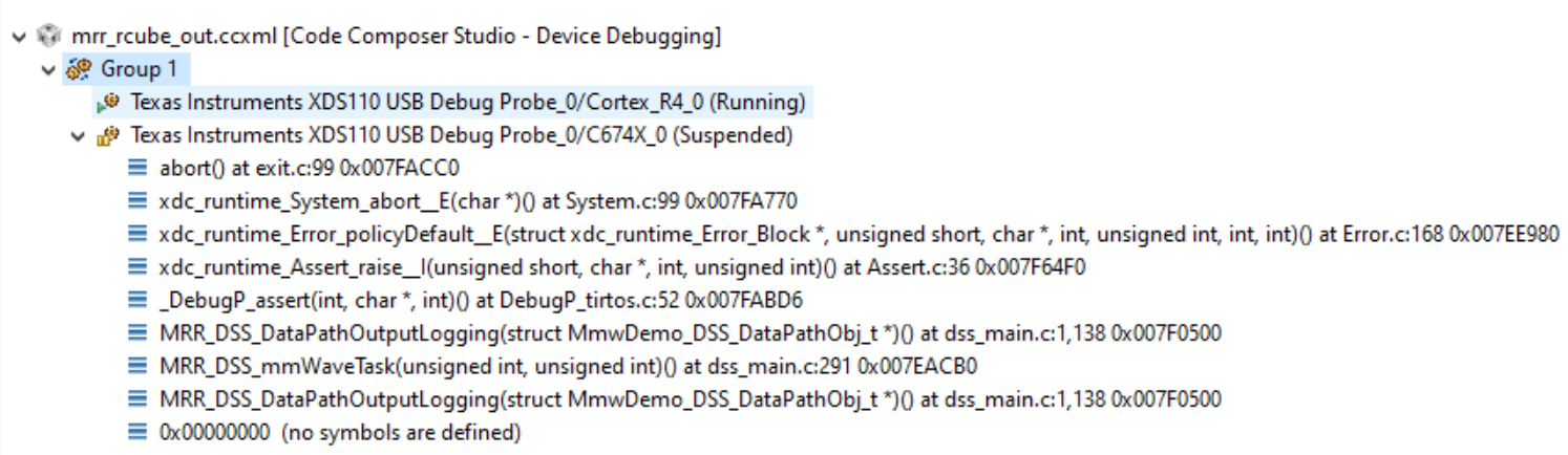

I'm trying to get some raw 1-D/2-D FFT radarcube data out along with clustering and tracking results using UART in the Medium Range Radar project for AWR1843. So, I did a little modification in the code (shared below), which compiles perfectly.
But when I try to download the images to 1843EVM by running target configuration, the script throws a runtime error after completion. I have adhered to data size and other limits in adding the TLV payload, so I am not able to identify the issue. It'd be great if you could have a look at added code (this is the only modification I've made in the whole project), or better, run this modification in MRR project and help me in figuring out the issue.
The code, console output and target configuration status are attached below.
Code: added after line 1000 in dss_main.c (before if (tlvIdx >= MMWDEMO_OUTPUT_MSG_MAX) statement)

Console output:
[Cortex_R4_0] Debug: Launched the Initialization Task
[C674X_0] Heap L1 : size 16384 (0x4000), free 6144 (0x1800)
Heap L3 : size 1048576 (0x100000), free 0 (0x0)
[Cortex_R4_0] Debug: Initialized the mmWave module
[C674X_0] Heap L1 : size 16384 (0x4000), free 1000 (0x3e8)
[Cortex_R4_0] Debug: Synchronized the mmWave module
[C674X_0] Heap L3 : size 1048576 (0x100000), free 262144 (0x40000)
Heap L2 : size 102400 (0x19000), free 21488 (0x53f0)
Heap L2 : size 102400 (0x19000), free 14432 (0x3860)
[Cortex_R4_0] Set LDO Bypass
Debug: MMWave has been configured for MRR.
Debug: Sensor will start momentarily.
[C674X_0] {module#8}: "../dss_main.c", line 1137: error {id:0x10000, args:[0x81d814, 0x81d814]}
xdc.runtime.Error.raise: terminating execution
target configuration status:

    There is not sufficient time to send the additional data. This is why an exception is generated.
    You need to estimate how much time you would need to send the data. Then check what frame rate would be needed.
    Thank you
    Cesar
  • Yes, the frame timing was definitely an issue - but this alone isn't fixing the issue. I changed the frame duration from 30 ms to 250 ms to ensure sufficient time for new data to be transmitted, but the run time error is still present.
    That may still not be sufficient time.
    If you need to transfer entire radar cube I recommend using a DCA1000 card to capture the raw data. That will give you more flexibility
    Thank you
    Cesar
  • Hi Cesar,
    Thank you for your suggestions. Yes, the problem was insufficient time only - the realized data rate of UART is lower than expected.
