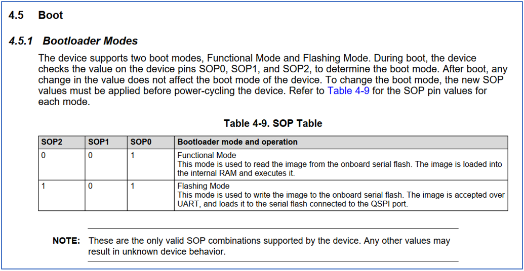

The IWR6843 operate in different modes (functional or flashing) based on the state of start on power pin SOP2.
But what ball no. is SOP2 in IWR6843 hardware?

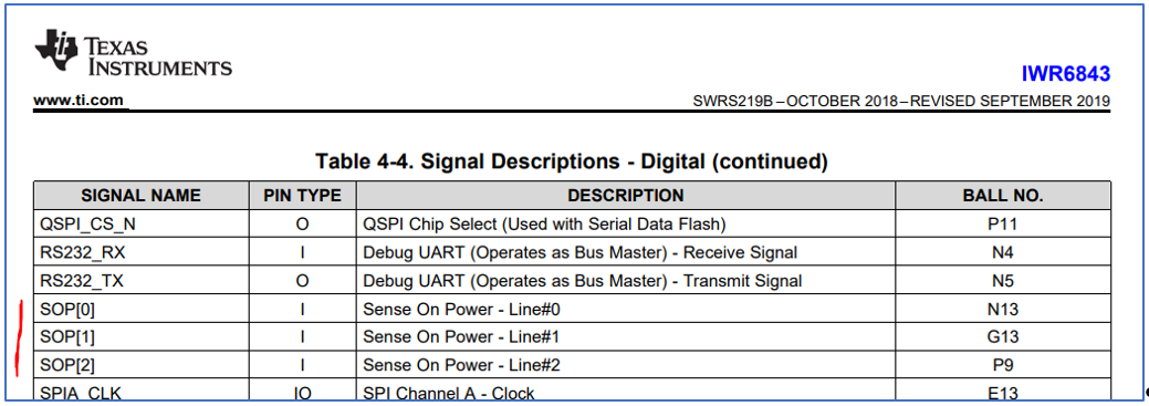

There are different specifications listed about that:
a)       SOP2 --> Ball No. “P9”
Datasheet "IWR6843 Single-Chip 60- to 64-GHz mmWave Sensor datasheet (Rev. B)" --> page 23
b)       SOP2 --> Ball No. “N13”
Design file “HardwareDesignChecklist_V0p8_IWR6843.xlsx | Customer IO List”
I just wondered what is the correct one?
