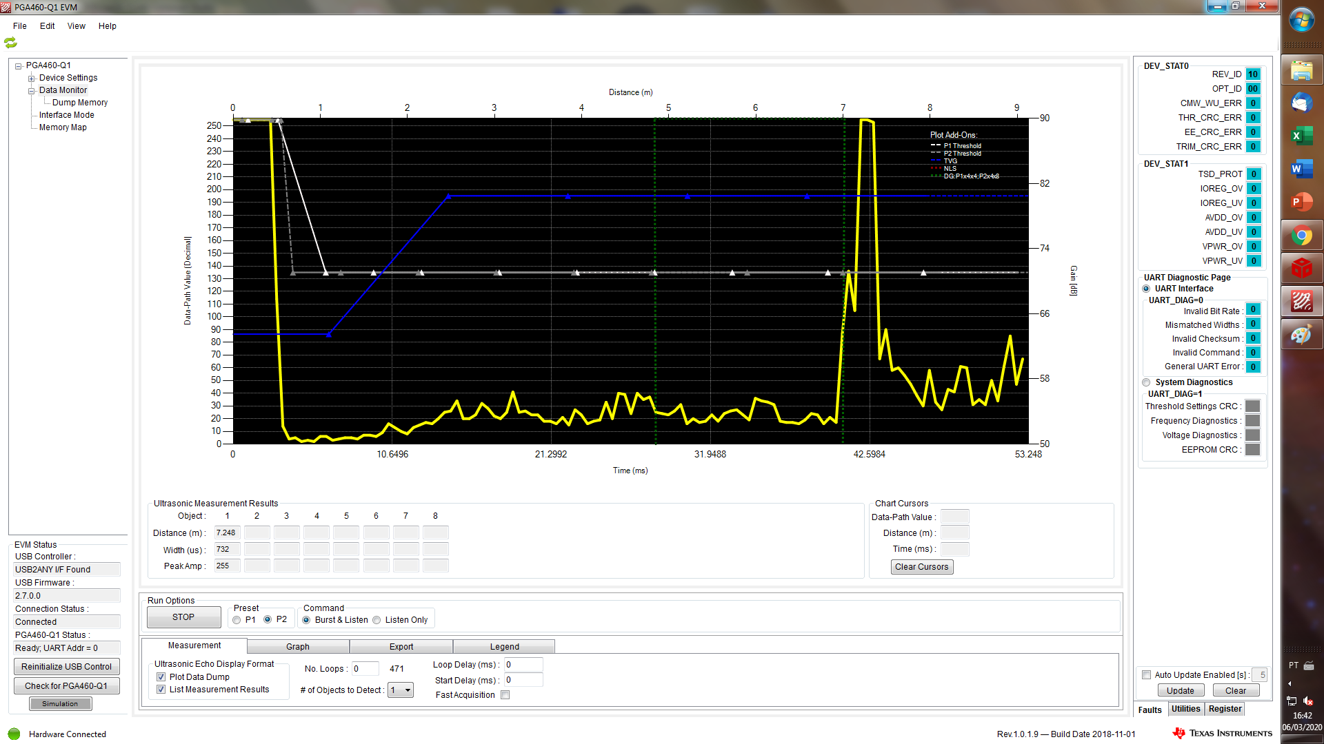

I have been change these values using a Texas Board with PGA460-Q1 EVM. When I saw a consistent signal I made a copy to these data to use in my proprietary hardware.
Using a datamonitor I sow a good signal to 8m or more.
In my proprietary board, until 5.61 meter works very well but MSB dont change. I don't believe in hardware problems ou poor signal. I wait 60ms to each burst and listen.

    Can you plot the echo data dump data (command 7; ensure DATADUMP_EN = 1) after your burst/listen command to see what your envelope looks like? This will help to determine if the threshold is mapped correctly to the envelope; otherwise, an incorrect threshold mapping may result in the wrong ultrasonic measurement result.
    Also, confirm the following:
    • You are writing to the threshold at least once after power-up/cycle and before the burst/listen command to clear the THR_CRC_ERR to '0'.
    • You are not mistaking the diagnostic field for the ultrasonic measurement results's MSB. Remember, every response command's first byte is the UART Diagnostic Data byte, which should be a value of 0x40 if there was no UART error. Considering your value is always 0x41, it almost looks like UART Diagnostic Data byte with the "device busy flag" set.
    • Ensure you wait a sufficient amount of time between the time the burst/listen command is sent to when you read back the ultrasonic measurement results. It looks like you have added a 60ms delay function in your code, but just verify you are waiting for the preset 1 or 2 record length time to expire before reading the ultrasonic measurement results.
  • Hi Akeem,
    Well, until now I''m dont use command 7, only command 5 to acquire a distance.
    The image below was taken using a Texas Board BOOSTXL-PGA460 and I can detect my target without problems.

  • Hi Akeem,
    I would like to thank you. You are right about the 0x41. I saw a byte 0, not a byte 1.
    After check again the MSB and LSB registers I saw that PGA worked well (in my proprietary PCB). See my data below:
    Target distance MSB LSB
    1m 0x17 0x31
    2m 0x2C 0xDC
    3m 0x43 0xA9
    4m 0xBA 0XCD
    5m 0X71 0xBE
    5,6m 01111101 01000000
    6m(stop to calculate) 10000110 00001110
    After my most significant bit are set my software are calculate wrong the distance. I'LL verify my variables but a problem is here:
    distancia = (((331/2)+0.3*tempok)*(((MSB<<8)+LSB)*0.000001))+(((331/2)+0.3*tempok)*(31*(1/80000))); // formula com compensação da variação da temperatura
    The variable tempok is the temperature in C°.
    Reinaldo
