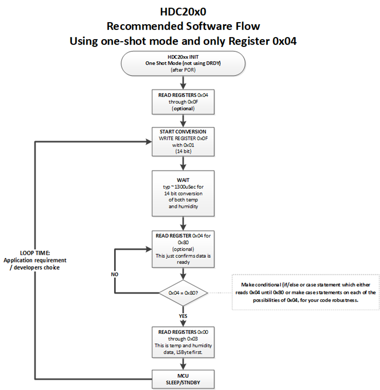

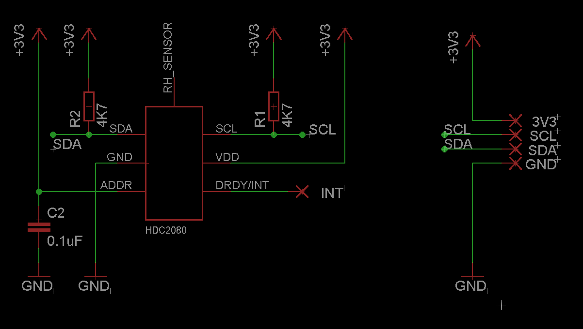

HDC2080: I can not read or write in register library
Part Number: HDC2080
Other Parts Discussed in Thread: HDC2010
Hi, i am studying with I2C and HDC2080. And I'm using stm32f030c6t, but i can not understand how to do this. I also read datasheet. And here is my example. Where am i doing wrong?
