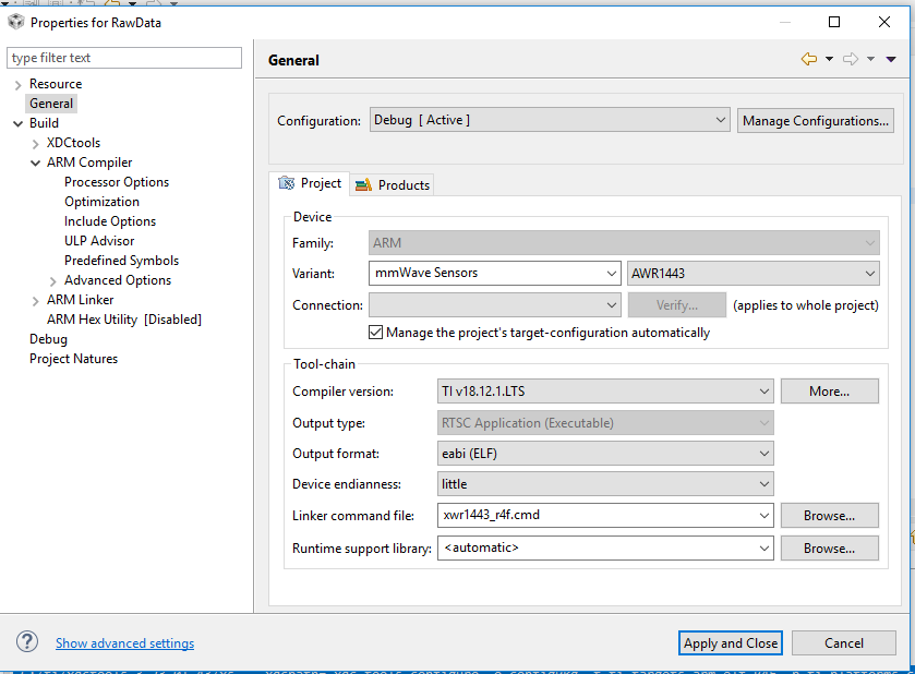

I am trying to build CSI Stream demo included in SDK 3.03.01.
Our intent, as mentioned in previous post, is the modify it to allow transmission over LVDS lanes (AWR does not have CSI2).
I cannot get to the end of the building process.
I am going to link a few components to try and clarify my current situation.
  1. MY ERROR LOG FROM BUILDING THE FILE
**** Build of configuration Debug for project RawData ****
"C:\\ti\\ccs901\\ccs\\utils\\bin\\gmake" -k -j 8 all -O
Building file: "../xwr14xx/mss.cfg"
Invoking: XDCtools
"C:/ti/xdctools_3_23_01_43/xs" --xdcpath= xdc.tools.configuro -o configPkg -t ti.targets.arm.elf.R4F -p ti.platforms.cortexR:AWR14XX -r debug -c "C:/ti/ccs901/ccs/tools/compiler/ti-cgt-arm_18.12.1.LTS" "../xwr14xx/mss.cfg"
xwr14xx/subdir_rules.mk:19: recipe for target 'build-1042546689-inproc' failed
js: "C:/ti/xdctools_3_23_01_43/packages/xdc/tools/Cmdr.xs", line 51: Error: xdc.tools.configuro: Error: Can't find platform package ti.platforms.cortexR
gmake[1]: *** [build-1042546689-inproc] Error 1
gmake: *** [build-1042546689] Error 2
xwr14xx/subdir_rules.mk:16: recipe for target 'build-1042546689' failed
gmake: Target 'all' not remade because of errors.
**** Build Finished ****

3. A FEW IMAGES FROM MY PATH AND CCS
  • Michele,
    You will need to use an SDK that includes firmware support for AWR1443. It looks like the version you are attempting to use is mmWave SDK v3.1.1.2. This particular release does not include a BSS image for AWR1443. Please migrate to using at least mmWave SDK v3.2.0.4 or later and these releases include a BSS image for AWR1443.
    Additionally, if you are using the setenv.bat file to set your build environment, then you should rebuild your project in the command line as well.
    However, what I would really recommend you do is use mmWave SDK v2.1 which you can download here: http://software-dl.ti.com/ra-processors/esd/MMWAVE-SDK/lts-latest/index_FDS.html
    This release includes an Out-of-Box demo for AWR1443 whereas later versions do not include it. I would recommend proceeding with your project on this release of the SDK if you plan to continue your development on AWR1443.
    Kyle

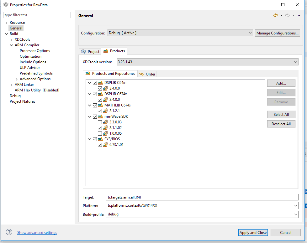

  • The first kind solution you have suggested seems unclear to me, so I tried to follow the second recommendation.
    If you think that would fix my issue, could you maybe elaborate a little more in-depth? I have zero previous experience with code composer studio building environment.
    I tried setting up the environmental variables inside code composer studio and they do seem to work.
    I followed the setenv.bat list of commands, but I set them up manually one by one. They seem to work fine, letting the project reach the same step it did before.
    I then selected mmwave sdk 2.1 from the list of currently applied packages in the same location as the 3rd image.
    This is the error I am getting:
    Invoking: XDCtools
    "C:/ti/xdctools_3_23_01_43/xs" --xdcpath="C:/ti/bios_6_73_01_01/packages;" xdc.tools.configuro -o configPkg -t ti.targets.arm.elf.R4F -p ti.platforms.cortexR:AWR14XX -r debug -c "C:/ti/ccs901/ccs/tools/compiler/ti-cgt-arm_18.12.1.LTS" "../xwr14xx/mss.cfg"
    making package.mak (because of package.bld) ...
    "ti/targets/ITarget.xdc", line 22:  can't resolve name (xdc.bld.ITarget3)
    js: "./config.bld", line 3: xdc.services.global.XDCException: xdc.PACKAGE_REPARSE_FAILED: C:\ti\bios_6_73_01_01\packages\ti\targets\arm\elf\package.xdc found along the package path, but its package files are incompatible with the current tools and could not be regenerated (InternalError: parser failed).  The package 'ti.targets.arm.elf' must be rebuilt with the current tools.
    gmake.exe: *** No rule to make target `.configuro'.  Stop.
    js: "C:/ti/xdctools_3_23_01_43/packages/xdc/tools/Cmdr.xs", line 51: Error: xdc.tools.configuro: configuration failed due to earlier errors (status = 2); 'linker.cmd' deleted.
  • Michele,
    Based on the errors that you are encountering, I would recommend that you rebuild the demo from the command line and not in Code Composer Studio.
    You should make any changes that you would like directly to the source files in the SDK folder.
    So, for clarification, this would mean working entirely within this directory: C:\ti\mmwave_sdk_02_01_00_04\packages\ti\drivers\test\csi_stream
    Use Notepad++ or your editor of choice to make any changes to the files that are you to make this project.
    Once you have made your changes, complete the following steps:
    • Open the command line,
    • Invoke the setenv.bat file
    • cd to the directory I listed above C:\ti\mmwave_sdk_02_01_00_04\packages\ti\drivers\test\csi_stream
    • Execute the following commands:
      • gmake clean
      • gmake all
    This will build the MSS executable found in the folder: C:\ti\mmwave_sdk_02_01_00_04\packages\ti\drivers\test\csi_stream\xwr14xx
    • xwr14xx_csi_stream_mss.xer4f
    You can then flash the CCS debug image to your AWR1443 device.
    This image is found in this folder: C:\ti\mmwave_sdk_02_01_00_04\packages\ti\utils\ccsdebug
    You will flash the xwr14xx_ccsdebug.bin image to your device.
    Now you can open CCS, launch a target configuration for AWR1443, and then load the MSS executable that was generated in the earlier step.
    The mmWave SDK User Guide provides for detailed instructions on all of the steps that I have listed. You should refer there for more information.
    The User Guide is found here: C:\ti\mmwave_sdk_02_01_00_04\docs
