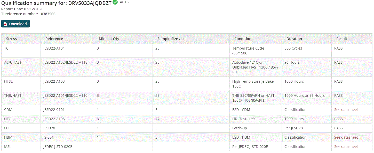

Please let me know what kind of reliability test was carried out for DRV5033.
(ex. JESD22-A104)
(ex. JESD22-A104)
DRV5033 is available in standard and automotive grades (DRV5033-Q1). The Automotive grade was tested to meet AEC-Q100 specifications. The standard release followed internal qualification procedures typical to TI standards for tests such as Electrical Characterization, High Temp Storage, Autoclave, Temp Cycle, etc.
ESD ratings for each device are shown here:
DRV5033
DRV5033-Q1
Dear Scott,
Thank you for your reply.
Would you tell me the test condition about the temperature cycle?
The full details for any device are available by selecting Qualification Summary under the Quality and Reliability banner from the main TI website.
I've gone ahead an pulled this information for DRV5033AJQDBZT for you below. In the case of Temp Cycle, we do follow JESD22-A104.
