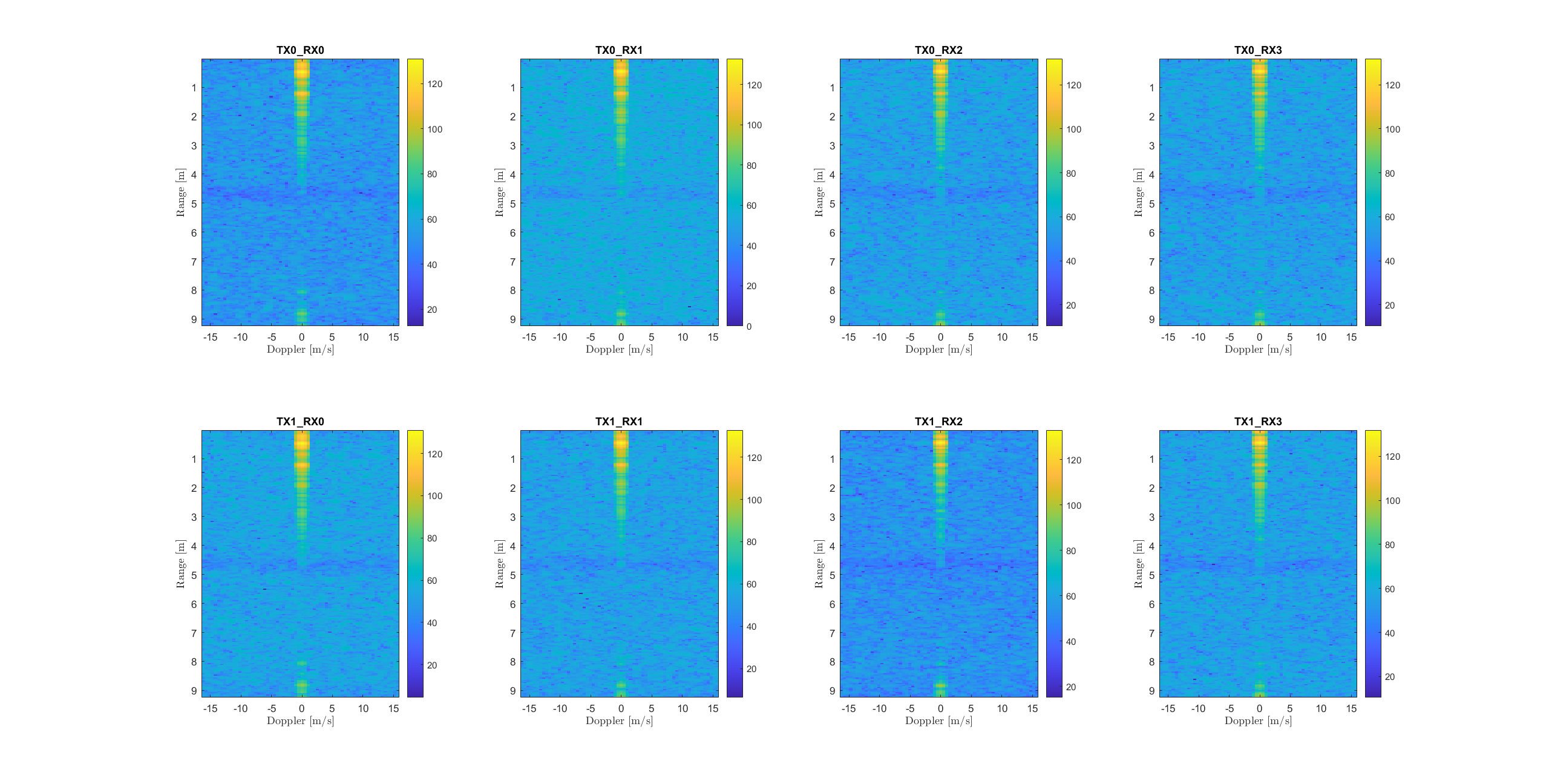

  • Hi Zigang,
    Thank you for your reply.

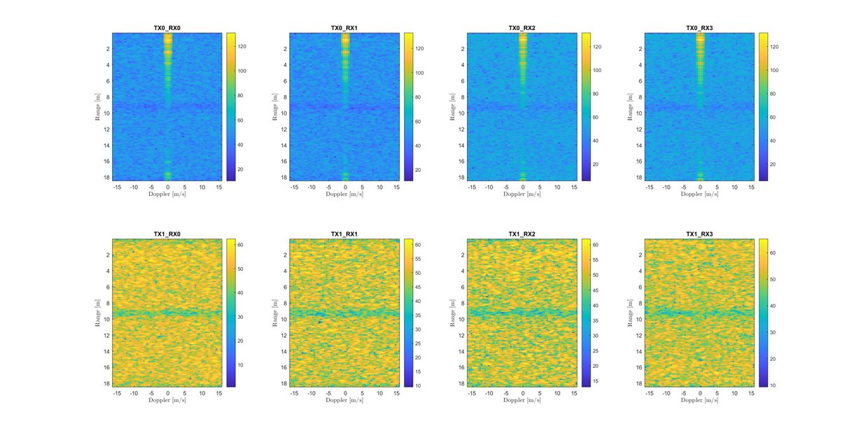

    I did the R-D spectrum for each pair of antennas for the BPD configured data. The Problem is it seems it is not showing correct result. Thats how i suspected that there might have some Problems for reading data.
     This is generated for the BPM configured data. For Tx1 it is not showing correct as Tx0.
    I have done with the TDM configured data and it seems it works fine.

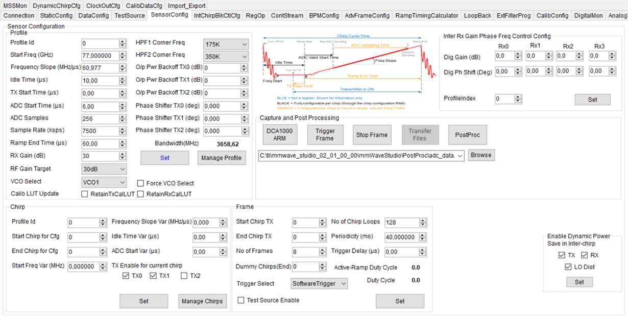

    Yes, you are right, but the Question is how to do it un this mmstudio. The steps are:
    Sensor Config Tab:
    1. Profile Configuration: I setup a profile with id 0.
    2. In chirp configuration : I configured only one chirp with the above profile id 0. Question is, Do I need to configure 2 chirps with id 0 and 1 with the same Profile configuration 0? I have tried it but it does not work for the same profile id 0. I have to set 2 profile with 0 and 1.
    3. Frame COnfiguration: Here I set Start chirp 1 and end chirp 2, which makes sence.

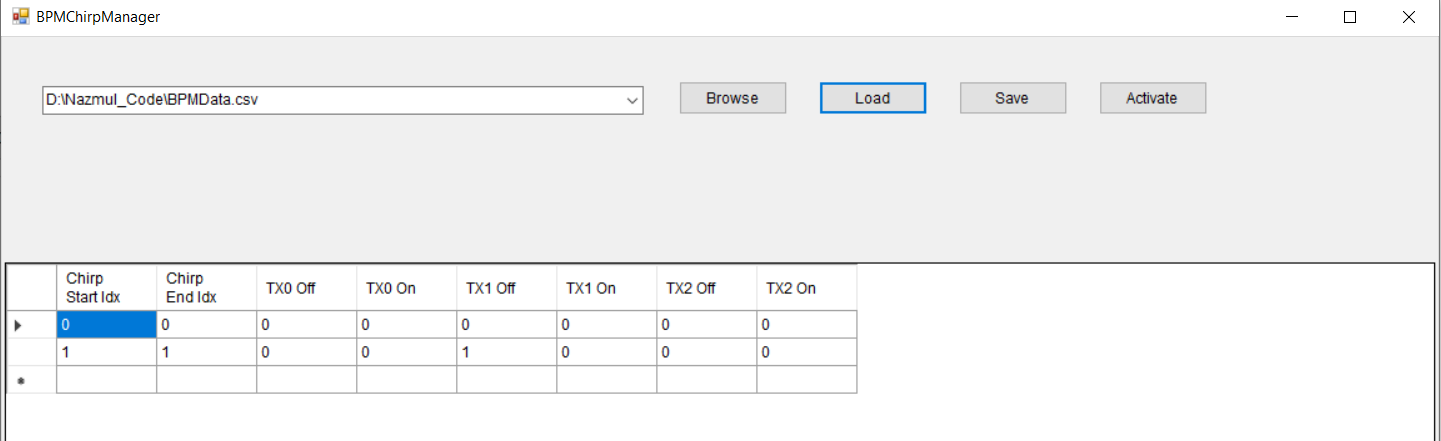

    BPM Configuration tab: What to do here, Can you please tell me in details. Which one to configure, BPM Chirp Config or the Chirp based phase shifter? I read about BPM theory from documentation but no where it is mentioned how to set up the BPM in mmwave studio. It is more about the User Interface.

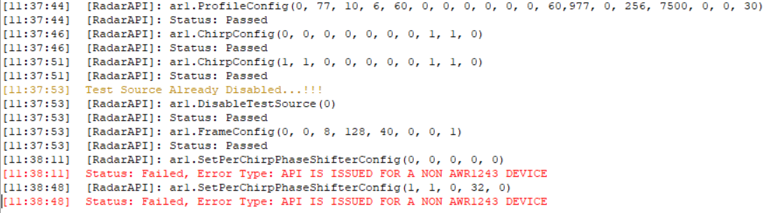

  • HI, Nazmul:
    You should not have problem configure different chirp with same profile configuration.  You can do:
    ar1.ChirpConfig(0, 0, 0, 0, 0, 0, 0, 1, 0, 1)
    ar1.ChirpConfig(1, 1, 0, 0, 0, 0, 0, 1, 0, 1)
    ar1.FrameConfig(0, 1, 8, 64, 40, 0, 0, 1)
    Assume you will use TX1 and TX3 to do BPM.

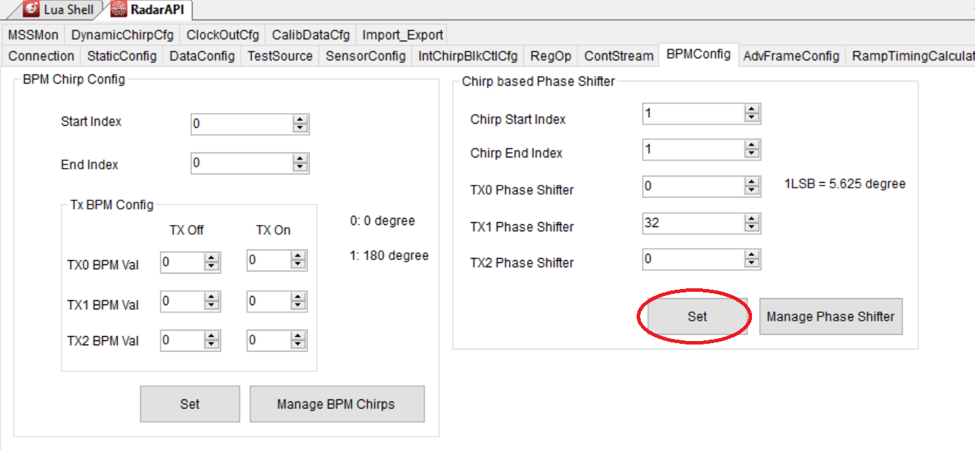

    And then program the phase shifter for chirp0 and chirp1 as below:
    ar1.SetPerChirpPhaseShifterConfig(0, 0, 0, 0, 0)
    ar1.SetPerChirpPhaseShifterConfig(1, 1, 0, 32, 0)
    THis command can be programmed in the BPMConfig tab as below:
    Zigang
    I have activated Tx0 and Tx1. Then I tried to follow you. The BPM configuration does not work.
    I am using IWR1443. Why this error message is generating?
    Nazmul
  • HI, Nazmul:

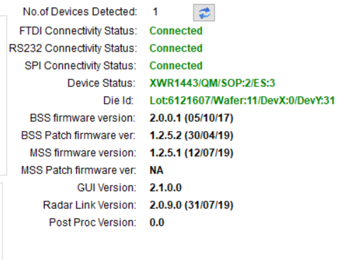

    Which radar studio version you are using and which BSS/MSS firmware you are loading?   Which version is your xwr1443 device.   I do not have this problem.   By the way, your frameCfg is still have one chirp instead of two.
    Zigang
  • Hi Zigang,
    I am using mm Studio 2.1.0.0. The BSS and MSS files are located,
    C:\ti\mmwave_studio_02_01_00_00\rf_eval_firmware\radarss\xwr12xx_xwr14xx_radarss.bin
    C:\ti\mmwave_studio_02_01_00_00\rf_eval_firmware\masterss\xwr12xx_xwr14xx_masterss.bin
    I have corrected the Frame config but still the same error. Thank you for mentioning.
    Nazmul
  • HI, Nazmul:

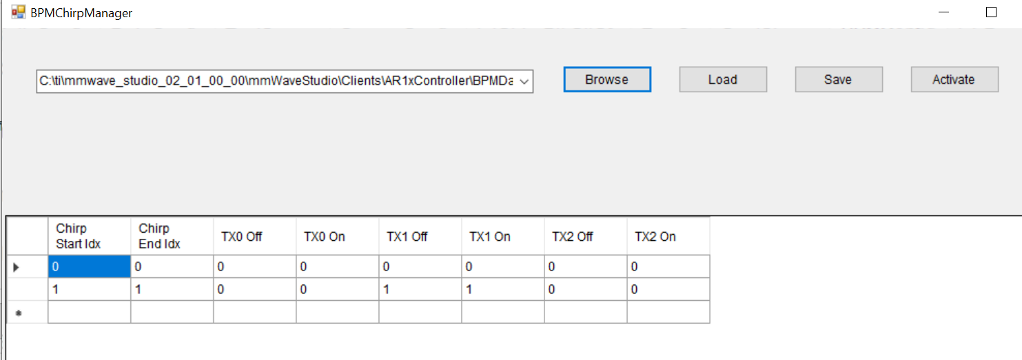

    It is very possible that xwr1443 does not support flexible phase shifter and only support binary phase shifter.  I am in the process to confirm with the design team.  For now, please try to configure the binary phase shifter as follows and try again.  The chirp Cfg and frame cfg should still keep the same.
    Zigang
  • Hi Zigang,
    Sorry for the late reply because of the corona situation.
    Following your way it seems the problem is solved and I am getting proper RD spectrum for 8 virtual antennas.
    Thanks a lot for your help.
