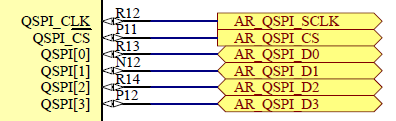

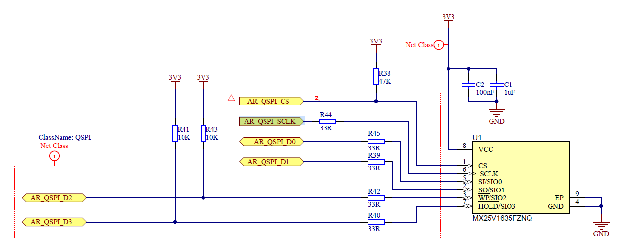

    Screens of flash parts in our schematics (but external flash itself works and it boots from first location):
    Thank you.
    Best Regards
    Petr
  • Sorry, here are schematics mentioned in previous post
