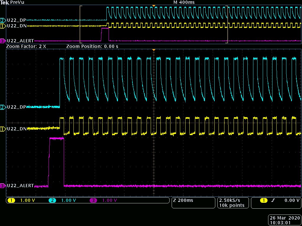

Hi Jim,
Polling one time per second should not be an issue. Getting a reading of 127 °C could indicate an open or short on the D+ pin. Can you please check the Status register and any alert pins to see if this is the case?

Hi Jim,
No, the status register will not indicate a short condition. Can you please send an oscilloscope waveform of the D+ and D- pins for the conversion that results in a 127 °C reading? This should be the conversion right before the Alert pin is asserted and can be used as your trigger for the oscilloscope.

Hi David,
We have checked the D+/ D- pin and no open or short issue found.
Do you have other suggestions or comments for calrifying why we get 127C from remote sensor ?

Hi Blake,
From the waveform it looks to be open as well. These remote pins inject different currents and read back a voltage at the different current levels. The change in voltage with respects to the current injection is dependent on the temperature of the thermal diode.
Since the thermal diode is open you can see that the D+ is railing at 3.3 V because the device cannot inject current into an open circuit. If you would like to learn more about how remote temperature sensors work you can read or watch some of the material I have posted below.
