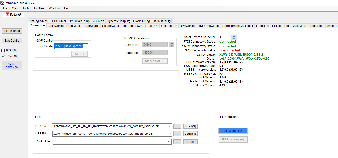

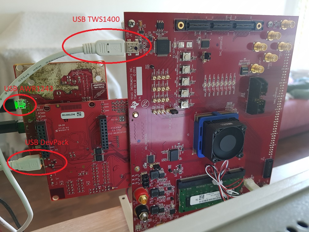

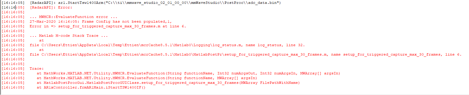

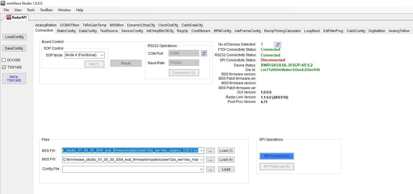

I'm using the AWR1243BOOST board with the TWS14000+DevPack board. I try to follow the steps described in the userguide using the mmwave Sudio but the SPI can't be connected as shown bellow :

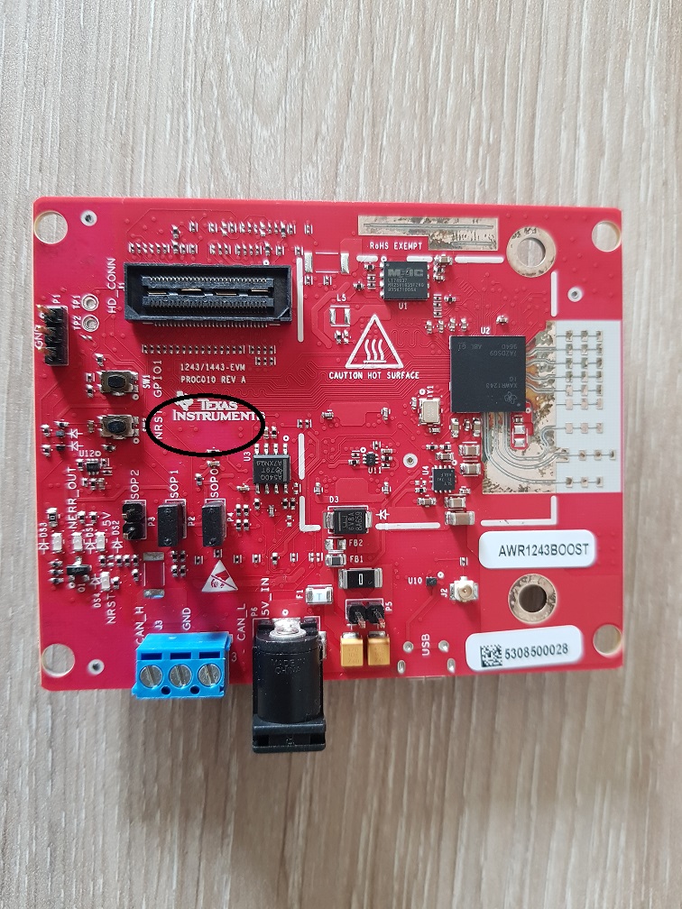

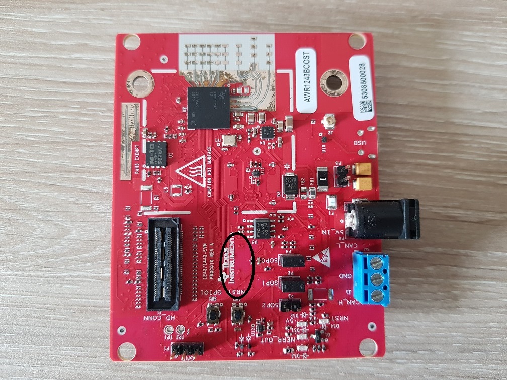

After many attempts, I just tried to compare the components of the AWR1243BOOST as described in the userguide (https://www.ti.com/lit/ug/swru507b/swru507b.pdf) with the actual board under test. And i could notice that i don't have the SPI and CAN Interface selector switch. It seems to be configured to be in CAN mode by default meanwhy the mmwave studio can't connect.
Can the AWR1243BOOST been replaced? or is there any alternative solution?
