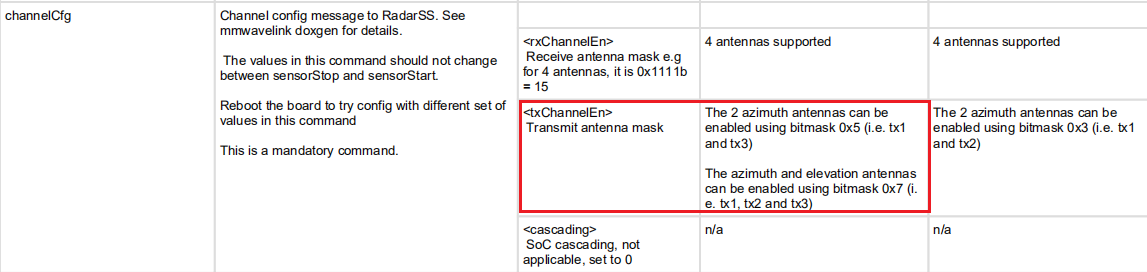

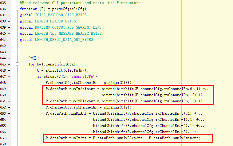

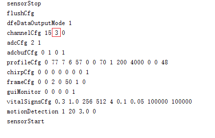

1. The profile_2d_VitalSigns_20fps.cfg shows that the third parameter of channelCfg is 3, which equals to 0x0011b, in other words, Tx1 and Tx2  antennas are used. I think that 1Tx and 1Rx antennas are enough to estimate the vital signs of single object. Why there need 2Tx antennas?

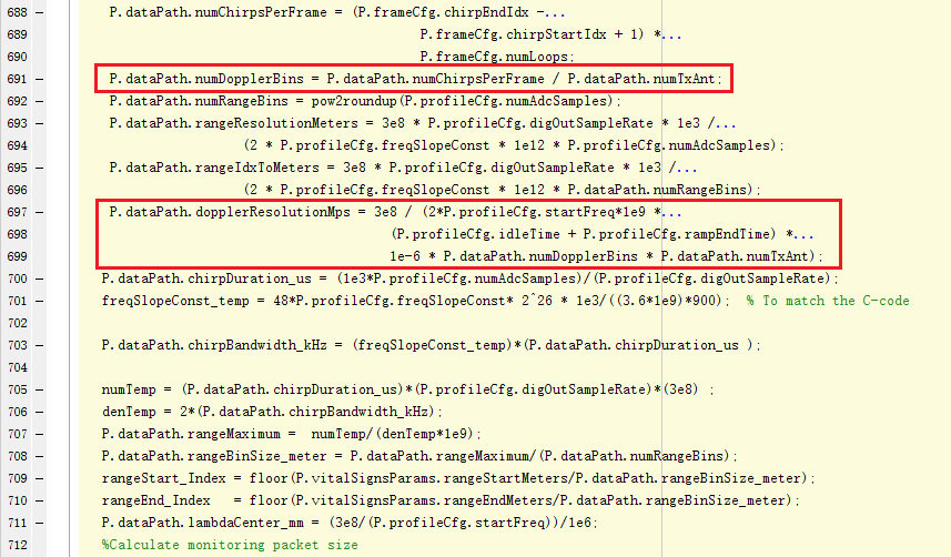

2. Line 691, why "P.dataPath.numDopplerBins = P.dataPath.numChirpsPerFrame / P.dataPath.numTxAnt"? In this way, P.dataPath.numDopplerBins = 2/2=1, because P.dataPath.numChirpsPerFrame = 2, and P.dataPath.numTxAnt=2, too. Shouldn't it be the number of samples before Doppler-FFT, such as 256 ? The number "1" is really too small to do Doppler-FFT, and as a result, the doppler resolution will be bad..

    While all of the antenna are enabled, only 1 Tx and 1 Rx are being used. If there were multiple then one would need multiple chirpCfg lines.
    Please note that the Vital Signs Lab is provided as-is and support for it is currently limited.
    AG
    In my opinion, the number of Doppler bins is frames number, not the chirps number per frame corresponding to one Tx antenna.as shown in Line 691. So, I don't really know what's the meaning of Line 691.
