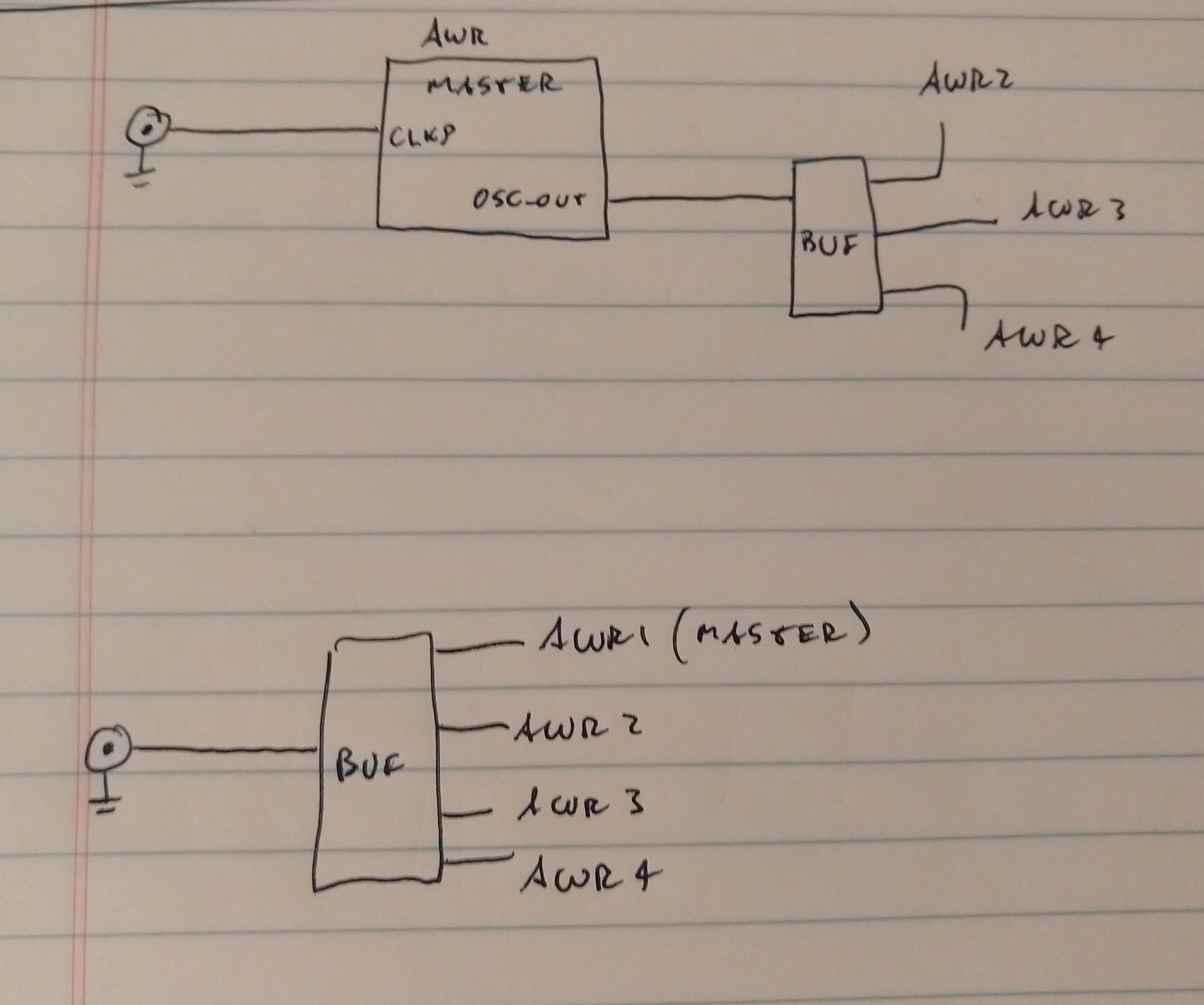

I am designing a custom cascade board using an external clock. Have you found any impact of the clock distribution network?
1) External clock -> AWR master -> 1:3 clock buffer -> 3 slaves
2) External clock -> 1:4 clock buffer -> AWR master and slaves
See figure attached:
Is there a reason to prefer option 1 or 2?
Antonio
  • Hi Antonio,
    We go for option #1 since it represents a slightly lower BOM and makes use of the low jitter, low phase-noise, crystal oscillator circuit built into the AWR devices. In the case of option #2 the designer needs to provide their own clean clock source.
