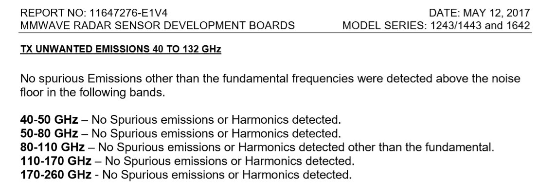

  • Hi Chethan,
    I’m interesting in bigger harmonics/subharmonics level.
    It’s necessary to design antenna for radars.
    It seems that 78.5 GHz should be used as central frequency according 2134.AWR1642_AWR1443_antennas_simulation2.pdf
    I would like to get 117 GHz and 39 GHz harmonics/subharmonics level or suppression if there isn’t any one bigger than those.
    Gennadii
  • Gennadii,
        Thanks for your intent clarification, Yes, 78.5GHz would be used as central frequency.
    I looked at our emission test reports for the ETSI certification, Tx unwanted harmonics were not detected or it was below the measurement equipment capability from 40GHz to 260GHz.
    Also Tx and Rx ports are very narrow bandwidth, Harmonics levels are very low to be affecting front ends.
