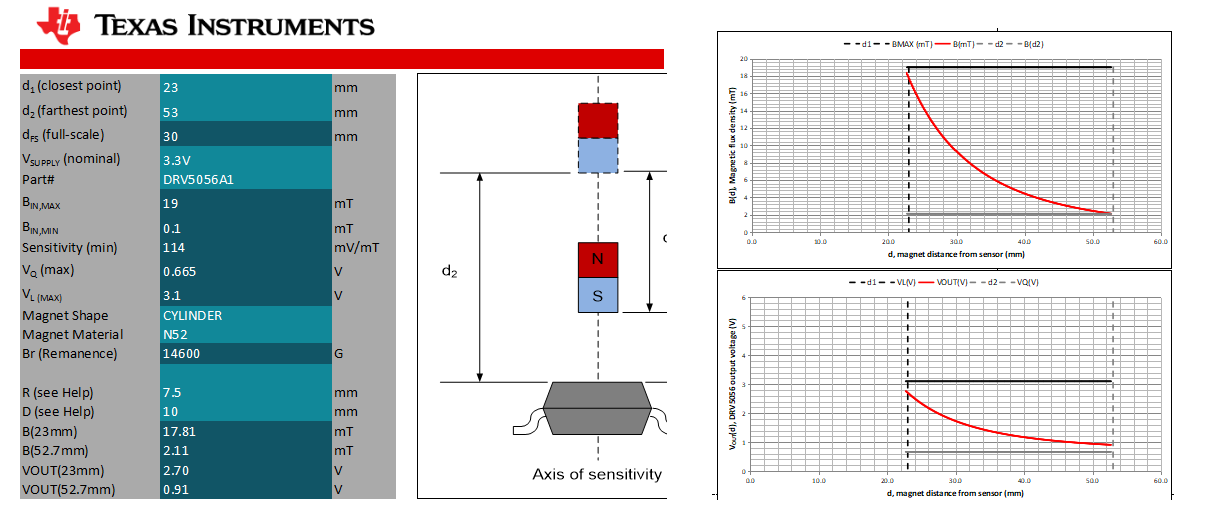

  • Hello Tirthal,
    Thank you for using the TI forum.  There are many aspects to think about here.
    My fist note would be that if you are using a head-on approach (as in the magnetic calculator you used above), then you may want to use the DRV5056 instead of the DRV5055.  The DRV5056 is very similar, but is unipolar which will allow you to use the full scale range of the device if you only plan to use one pole of the magnet.

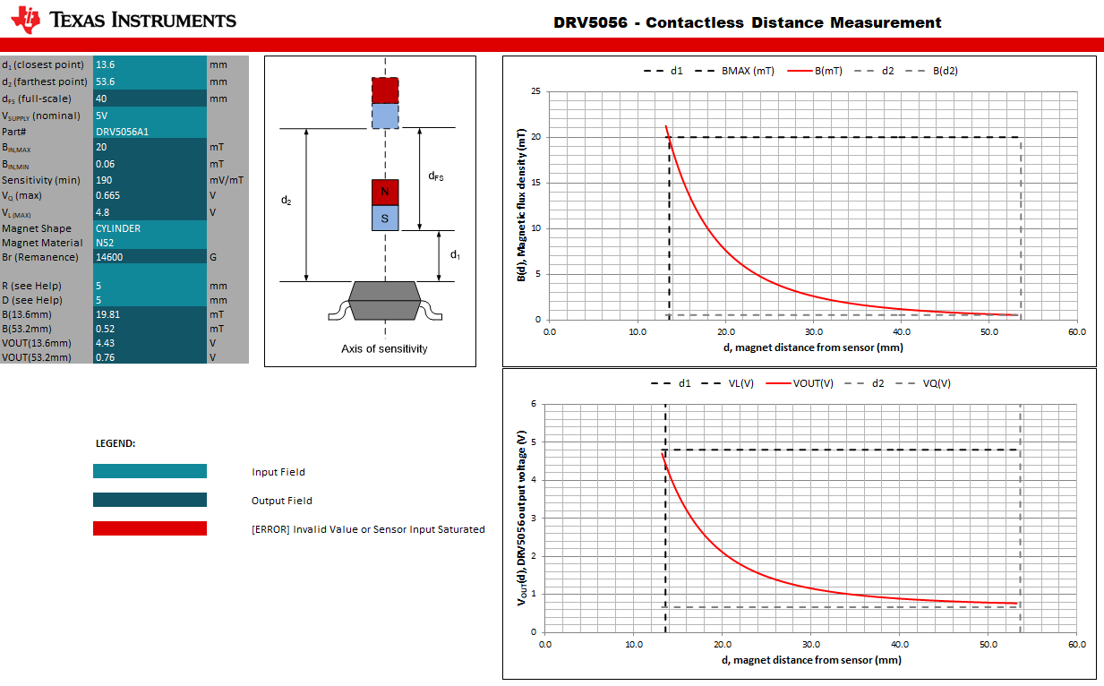

    Also, whether or not you can do this with just one sensor depends largely what kind of measurement resolution/accuracy you require. I recommend using the DRV5056 distance measurement tool to help you get an idea of what to expect.  The tool can be found here: https://www.ti.com/lit/zip/sbac231. This is an example of what it looks like with your specifications:
    I adjusted the start stop position to start farther away form the magnet (13.6mm) so that the sensor was not railed. I recommend trying different sensor versions and magnet shapes to get results that work for you. Note, the measurement resolution will be lower as the magnet gets farther away from the sensor.
    If you cannot find a setup that works for your accuracy requirements with just one sensor, you can use 2 or more sensors combined data to get better results across your whole movement path.  These options change significantly based on your design requirements/setup, so if you end needing more help with that, just let us know.

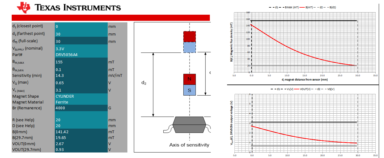

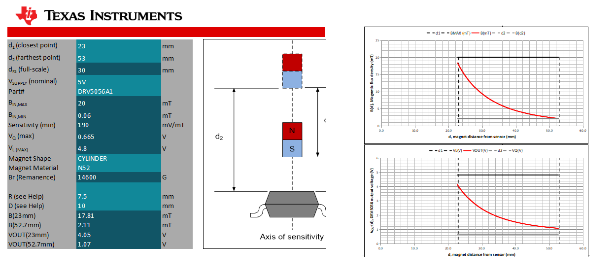

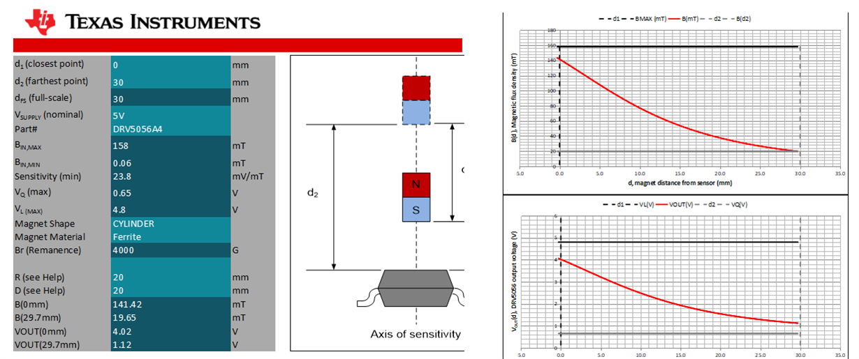

    -->One more thing i am operating the system on the 3.3v.I am also attaching the 3.3 v and 5.0 v readings with d=15  mm and thickness 10 mm with N52 magnet.
    I think this results are good,correct?
    And the above with ferrite magnet,but do you suggest to use ferrite magnets considering long functioning of the device?

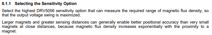

      • The datasheet says this about selecting a good device for your system:
    • Correct, your results look good, and it looks like you are using the tool correctly.
    • In regards to Ferrite vs Neodymium, it really can depend on your setup and mechanical requirements.  Note that with a ferrite magnet, you ended up using a much larger magnet. Also, if you expect large temperature changes, then the Neodymium will give you more consistent results across temperature because the DRV5056 drifts with temperature to compensate for neodymium magnets.
