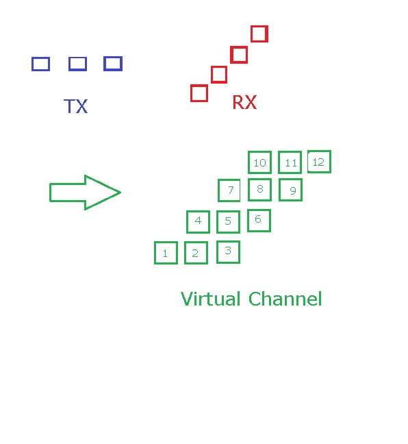

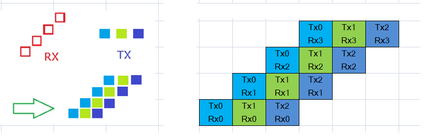

               If we use below antenna placement for MIMO application with  IWR1843 . The chipset & SDK could support these setting and have any guide for MIMO antenna & DSP design  ?
               for horizontal angle our data processing could  be use  no.1 2 3 10 11 12 virtual channel for processing and the angle resolution be max antenna FOV/ 6 .
               for vertical angle our data processing could be use no. 3 5 7 10 virtual channel for processing and the angle resolution be max natenna FOV /4 .
               If above is ok , how to implmentation with mmwave SDK part.  now's mmwave SDK version lack these parameters description . can help or give suggestion ?
