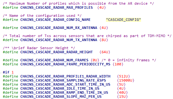

I tried to increase the number of sampling points in radar MIMO mode from 256 to 512, but an error occurred:
This is the configuration I used:
Are there any other parameters that need to be changed?
Thank you for your help.

    Apologies on my delay in responding to this. There is a limit in the code for the total allocatable buffer sizes to ~300 MB. When you increase the sampling points the buffer size becomes larger and then causes the total size to be beyond ~300 MB.
    You can refer to https://e2e.ti.com/support/processors/f/791/t/567237 for a guide on how to change the memory map to increase the size of the DDR.

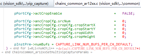

  • Hi Piyali,
    I changed the DDR used by the BIOS from 512M to 1024M, but I still couldn't reach 512 sample points and 128 chirps,so I made the following changes to the code:

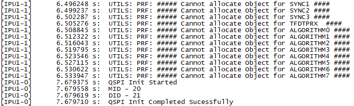

    Now the code is working, but it will print this when it starts:
    Will this cause any problems?

  • JG
    You should not be reducing the buffers for the VIP capture, you may start seeing dropped frames, Can you please highlight what were the memory map changes you have made?

    2.I modified it according to chapter 6.5 of the VisionSDK_UserGuide_MemoryMap document you provided.
    I am now using SDK3.7. The configuration in this SDK is as follows:
    And I noticed that the configuration used in SDK3.8 changed to:
    So this goes from 16 to 6. Why does this parameter vary so much in SDK3.8?

  • JG
    For Doppler FFT we support only power of 2 sizes.
    So this goes from 16 to 6. Why does this parameter vary so much in SDK3.8? --> This is done to reduce the memory requirement. Please note one should not go below 6 as the VIP timing versus the processing timing causes the buffers to start dropping.
