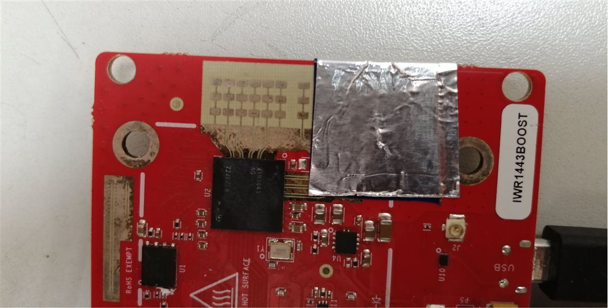

We have discovered Tx-Tx leakage on IWR1443.
We measured IWR1443BOOST received signal voltage from reflector. Tx1 was open to air. Tx2 and Tx3 were covered with dielectric and aluminum foil.
Tx1 was active on first chirp. Rx signal was U.
Tx2 was active on second chirp. Rx signal was 10-15% of U.
Tx3 was active on third chirp. Rx signal was 10-15% of U.
But Rx signal corresponding Tx2 and Tx3 active should be zero.
The leakage was even more on custom board having longer Tx1 feed line and unconnected (cut off) Tx2 output.
What is the reason of leakage and how it can be reduced?

  • Hi Vaibhav,
    The leakage is a signal from the reflector.
    It's just a copy of signal U but having lower amplitude.
    Gennadii

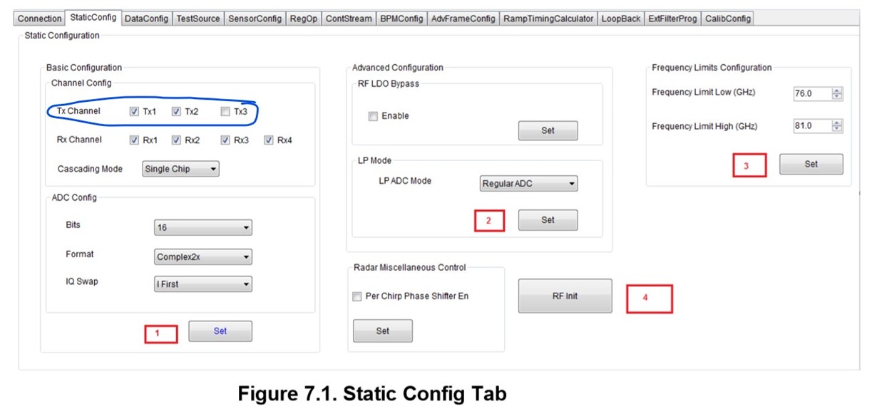

    In the above case: We have two mechanism
    1) Selecting right Tx chain through the profile configuration: In this configuration you could select right transmitter of your choice.
    However in this case other transmitter chains (Not selected) would be enabled but would not be chirping.If your design doesn't have other transmitter active at all then below 2nd option is better.
    2) In this option by selecting only desired Transmitter and receiver section completely shuts of other Tx and Rx pairs which are not selected.
    Hence you would not see any leakages, from other transmitter which are not in use in the system.
    These are screen shot from mmWave studio, however you could use the same APIs from the mmWave SDK as well to achieve same desired results.

  • Hello Chethan,
    We have done step (2). Electrical tape and foil was used. We still have 12 dB leakages. We have seen Tx leakage for open antenna using our software but not RadarStudio.
    Gennadii

       Thanks for sharing the results,
    From the images shared 1) Tx open and Tx covered couldn't see the difference between the images. I guess this is just a typo. I couldn't see the step 2 configuration in the images that is attached.
    2) on the x-axis range bin where tx and Rx leakage seen seem to at higher distance than at where Antennas are located. Could you change the chirp, configuration and confirm this? It may be possible leakage would be coming from elsewhere.
    3) Typically to suppress Tx-Rx leakage at board level / Ramdome level mmWave absorber materials are used. Foils are not recommended.
